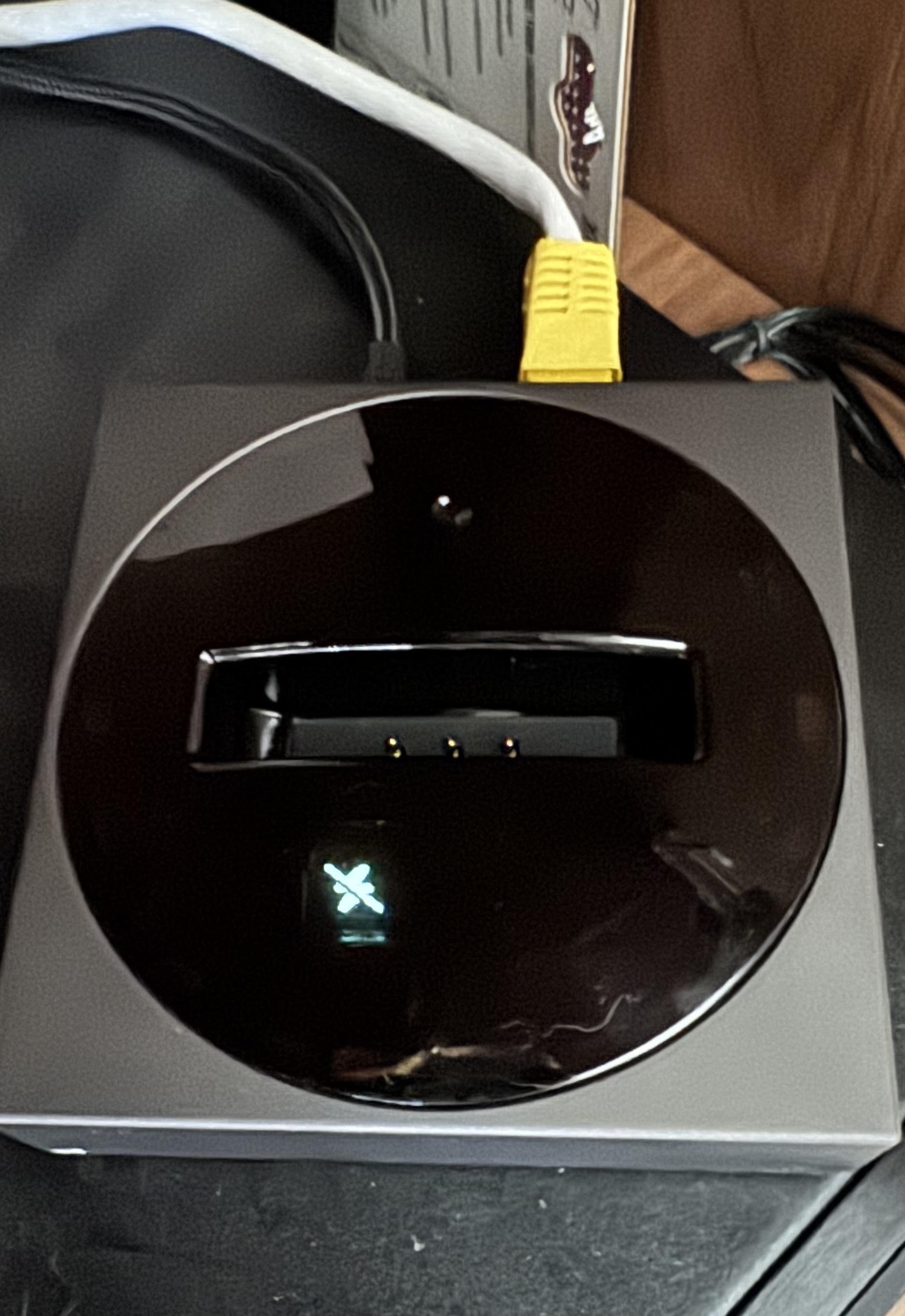

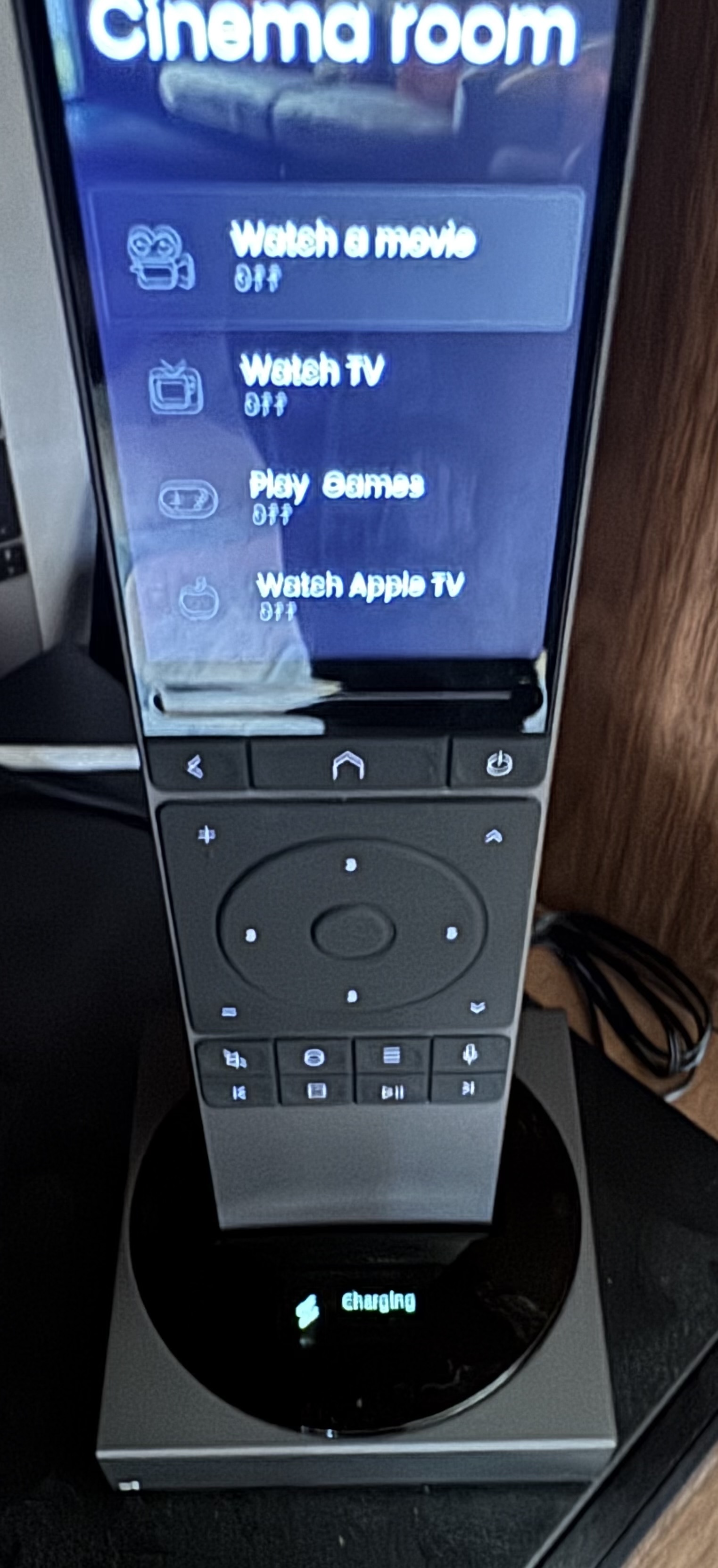

Hi @iordish I’ve had the same charging issue since getting the remote — the only way I could get it to work initially was by unplugging and plugging the dock back in. However, I was recently updated to firmware 0.7.0, and I’m pleased to say it does now seem to be charging correctly. It’s only been a couple of days, but so far so good.
I’m powering the dock via PoE, and since the update, the dock screen shows “charging” for a minute or two when the remote is placed in the cradle — this never used to appear. After that, the message disappears, but charging continues.
Also, when the remote is removed, a new symbol with a lightning bolt through it appears on the dock screen to show it’s no longer charging. That visual feedback is really helpful.
I’ve attached some photos in case it’s useful. If you’re still having trouble, it might be worth contacting support at support@unfoldedcircle.com — replies can take a few days, but they’re usually helpful.
