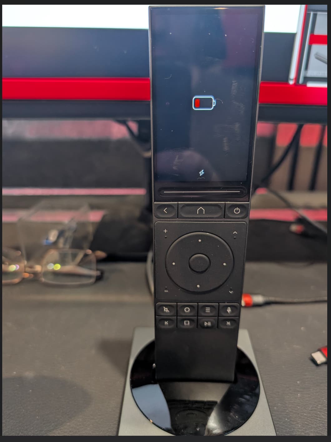

But the remote doesn’t charge on neither of my 2 docks. A powerbank with qi support did charge the remote.
Do i have to log a support ticket or is this a software issue with the dock or remote itself?

When connected remote to dock - is started to charge for few minutes then it stopped - and until I restarted remote it didn’t initiated charging again.
Qi charging (to be precise - it’s Magsafe chager with 15W output) - was very slow and also stopped charging after while - but it charged at least 1% per cycle - I think this was due to thermal protection as device was heating up during charge
I wasn’t even able to update to 2.5.6. because battery was ~10% and I wasn’t able to charge it to 50%.
Then I placed my Magsafe charger in front of AC and was able to charge it to 100% in about 2 hours. This leads me to conclusion - there might be some thermal protections which are causing those issues.
Now it’s updated to latest firmware and in dock sowing 100% for last 12 hours - let’s see what happens when I drop battery by 20% and then try to charge it…
