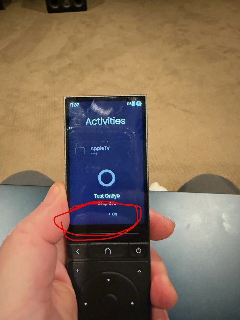

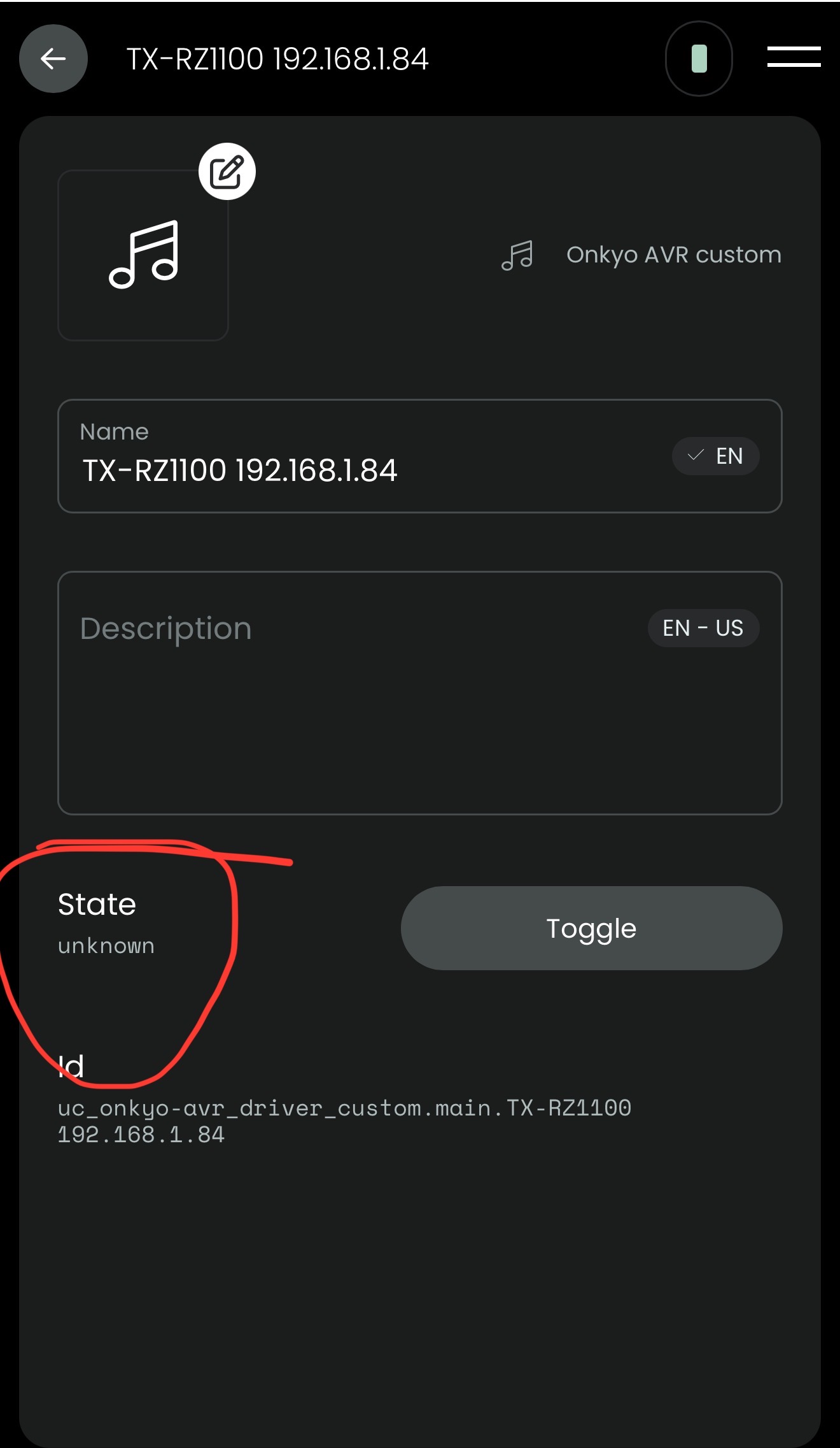

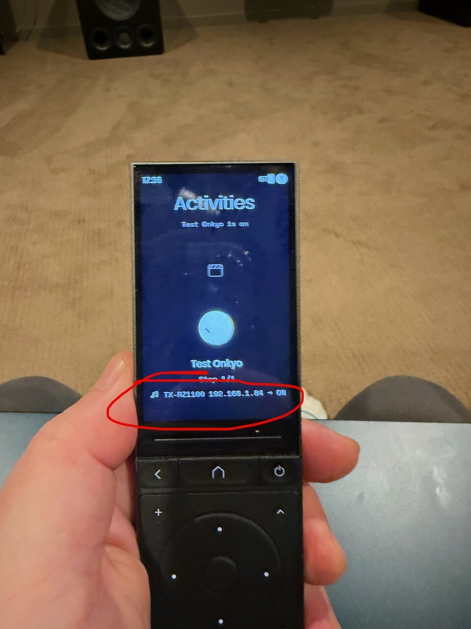

Unfortunately, same behavior on this new version. I installed it, it worked fine, state was “standby” or “on” and able to be toggled, tested all activities, rebooted the remote, then I got errors and an “unknown” state. Only recovery is to reinstall. Sorry!
Coukd you again send me the logs?
And, does it help if you reboot twice?
Unfortunately, rebooting multiple times does not fix it.
Logs below…hopefully these are what you need. I hit character limits so I’ll separate it into 2 posts. Post 1 is the reinstall of the integration. Post 2 is the successful operation of the Onkyo and the reboot of the remote and failure of the Onkyo.

At 51sec I successfully toggled the Onkyo on and off using the “Test Onkyo” activity (log below)
2025-10-29 17:51:07.266975 +00:00 node-intg-uc_onkyo-avr_driver_custom INFO Onkyo-Integration (receiver): [TX-RZ1100 192.168.1.84] audio-muting set to: false
2025-10-29 17:51:07.186098 +00:00 node-intg-uc_onkyo-avr_driver_custom INFO Onkyo-Integration (receiver): [TX-RZ1100 192.168.1.84] input-selector (source) set to: stm
2025-10-29 17:51:07.005156 +00:00 node-intg-uc_onkyo-avr_driver_custom INFO Onkyo-Integration (receiver): [TX-RZ1100 192.168.1.84] power set to: ON
2025-10-29 17:51:06.706313 +00:00 core NOTICE Removed standby inhibitor: activity ‘Test Onkyo’ (off) (max 65s)
2025-10-29 17:51:06.705613 +00:00 core NOTICE [Test Onkyo] activity finished
2025-10-29 17:51:06.698135 +00:00 node-intg-uc_onkyo-avr_driver_custom INFO Onkyo-Integration (sender): [TX-RZ1100 192.168.1.84] media-player command request: off {}
2025-10-29 17:51:06.694143 +00:00 core NOTICE [Test Onkyo] activity command: uc_onkyo-avr_driver_custom.main.TX-RZ1100 192.168.1.84:media_player.off
2025-10-29 17:51:06.693333 +00:00 core NOTICE Added standby inhibitor: activity ‘Test Onkyo’ (off) (max 65s)
2025-10-29 17:51:06.689768 +00:00 core NOTICE Started activity ‘Test Onkyo’ (uc.main.770bdf25-57b0-4711-a02f-7eaa6a7572f4) with timeout of 60s
2025-10-29 17:51:03.840710 +00:00 core NOTICE Removed standby inhibitor: activity ‘Test Onkyo’ (on) (max 65s)
2025-10-29 17:51:03.840398 +00:00 core NOTICE [Test Onkyo] activity finished
2025-10-29 17:51:03.836927 +00:00 node-intg-uc_onkyo-avr_driver_custom INFO Onkyo-Integration (sender): [TX-RZ1100 192.168.1.84] media-player command request: on {}
2025-10-29 17:51:03.823947 +00:00 core NOTICE [Test Onkyo] activity command: uc_onkyo-avr_driver_custom.main.TX-RZ1100 192.168.1.84:media_player.on
2025-10-29 17:51:03.823305 +00:00 core NOTICE Added standby inhibitor: activity ‘Test Onkyo’ (on) (max 65s)
2025-10-29 17:51:03.822689 +00:00 core NOTICE Started activity ‘Test Onkyo’ (uc.main.770bdf25-57b0-4711-a02f-7eaa6a7572f4) with timeout of 60s
2025-10-29 17:51:03.821827 +00:00 core NOTICE Starting activity ‘Test Onkyo’ (uc.main.770bdf25-57b0-4711-a02f-7eaa6a7572f4) in activity group: ‘Default’ (default)
2025-10-29 17:51:03.739625 +00:00 core NOTICE [UCD3-0CBB00] Reconnecting in: 5s
2025-10-29 17:51:03.739340 +00:00 core ERROR [UCD3-0CBB00] Error connecting to dock ws://192.168.1.79/ws: TimedOut
2025-10-29 17:51:03.736013 +00:00 core NOTICE [UCD3-0C8AB0] Reconnecting in: 5s
2025-10-29 17:51:03.734790 +00:00 core ERROR [UCD3-0C8AB0] Error connecting to dock ws://192.168.1.29/ws: TimedOut
2025-10-29 17:51:02.469990 +00:00 core NOTICE Setting rgb button backlight to: (191, 191, 191)
2025-10-29 17:51:02.468729 +00:00 core NOTICE Enter normal mode: standby in 1800s
At 52sec I rebooted the remote and after rebooting the Test Onkyo activity fails (and the entity now reads the status as “Unknown” (log below)

Bad news. Same behavior. Installed 0.6.3. Worked fine. Rebooted remote. Waited until ball stopped moving. Error trying the same activity. Here the log of the failed attempt:

Also, probably won’t help any, but the screen is different before and after reboot. As you can see below, before reboot the entire entity name is shown under Step 1/1. After the reboot the entity name is gone. That may be nothing, but thought I’d provide the additional data point.
Thanks for that info! I have reinstalled, power down/up, rebooted my remote many times but cannot replicate the issue.
The screenshots tell me I have to look into a different direction. Will chew on it some more and come back to you later this week.
