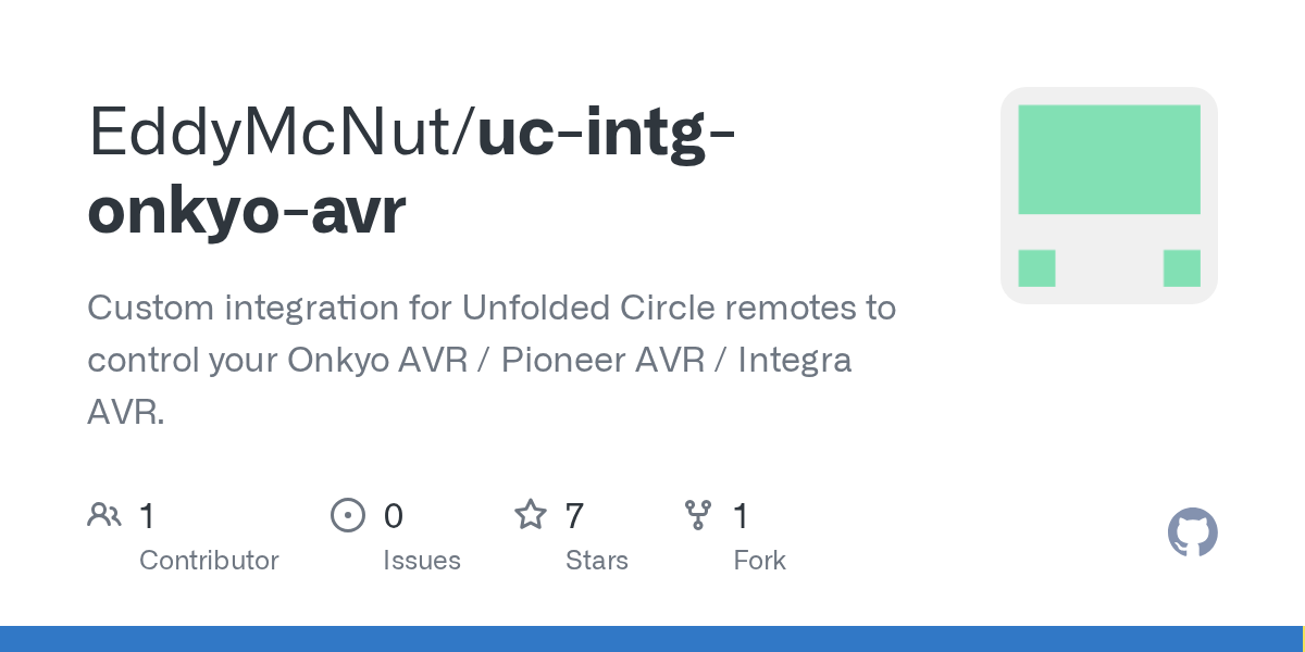

Started work on an 'Onkyo AVR / Pioneer AVR / Integra AVR' custom integration
Hi all, I would like to let you know that I have started work on an Onkyo AVR custom integration., now in version 0.0.1 It is in early development phase and please do read the README before you start playing with it. As it is early development breaking changes are to be expected so don’t just switch to it if your current setup has a high WAF for example.

Hi all, version 0.5.0 is now available.
MediaWidget:
  • show DAB station name
  • show artist, title, album and album art when using NET (which is also used for Spotify for example, see the updated readme)
Cheers, Ed
Hi all, version 0.5.3 is now available which has no problem anymore with reboots of the remote.
Also made a small change that allows for a slightly lower ‘overshoot threshold’ because the commands are send a bit faster to the AVR when long-pressing volume (while only short-press is assigned on the remote, see updated README).
Cheers,
Ed

Hi, the integration just exposes the AVR as mediaplayer.
With that you can control anything of the AVR, for example as part of an integration as described in the readme.
You can also just add the selected AVR to a page on the remote then some buttons are already mapped.

Hi all, released 0.5.4 which has a lot of changes under the hood. Also started to get the github project itself in better shape although that is still work in progress.
