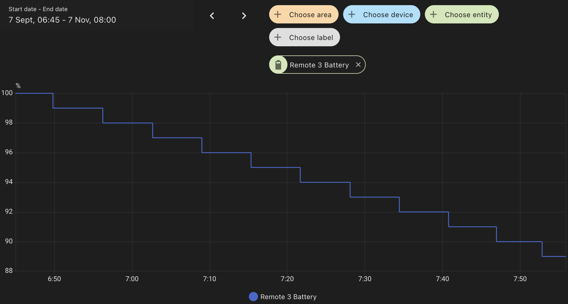

Yesterday I noticed the battery on my Remote 3 getting low quicker than usual. By 18:00 it was down to about 15%.
I charged it overnight so it was at 100% when I got up but it’s already dropped 11% in about an hour. Surely that’s not normal? I’ve got the Home Assistant integration setup so I’ve grabbed this graph from HA:

Sorry to say but with prevent sleep active around 12%/h is normal. My remotes lasts a whole day even at the weekend because I put it in a charger (Dock or wireless) when not used for a longer time.

Might be the firmware but I doubt that it is drastically. Installed and used integration can also effect the battery.
More interesting than only looking at the battery level is to look also at the 1min load and then compare with a log file to find a possible cause.

I grabbed some data from HA and can see that on the previous firmware (I forgot the version number) it’d use about 9%/hour so there or thereabouts to what I’m seeing now.
The data also showed that usage yesterday isn’t typical, on previous weekends there’s been periods of a few hours where the remote has gone to sleep because there wasn’t an activity running. Yesterday there was an activity running pretty much all day.
I do still find the battery life to be very poor but the %/hour hasn’t changed so what I noticed yesterday was based on higher usage.
