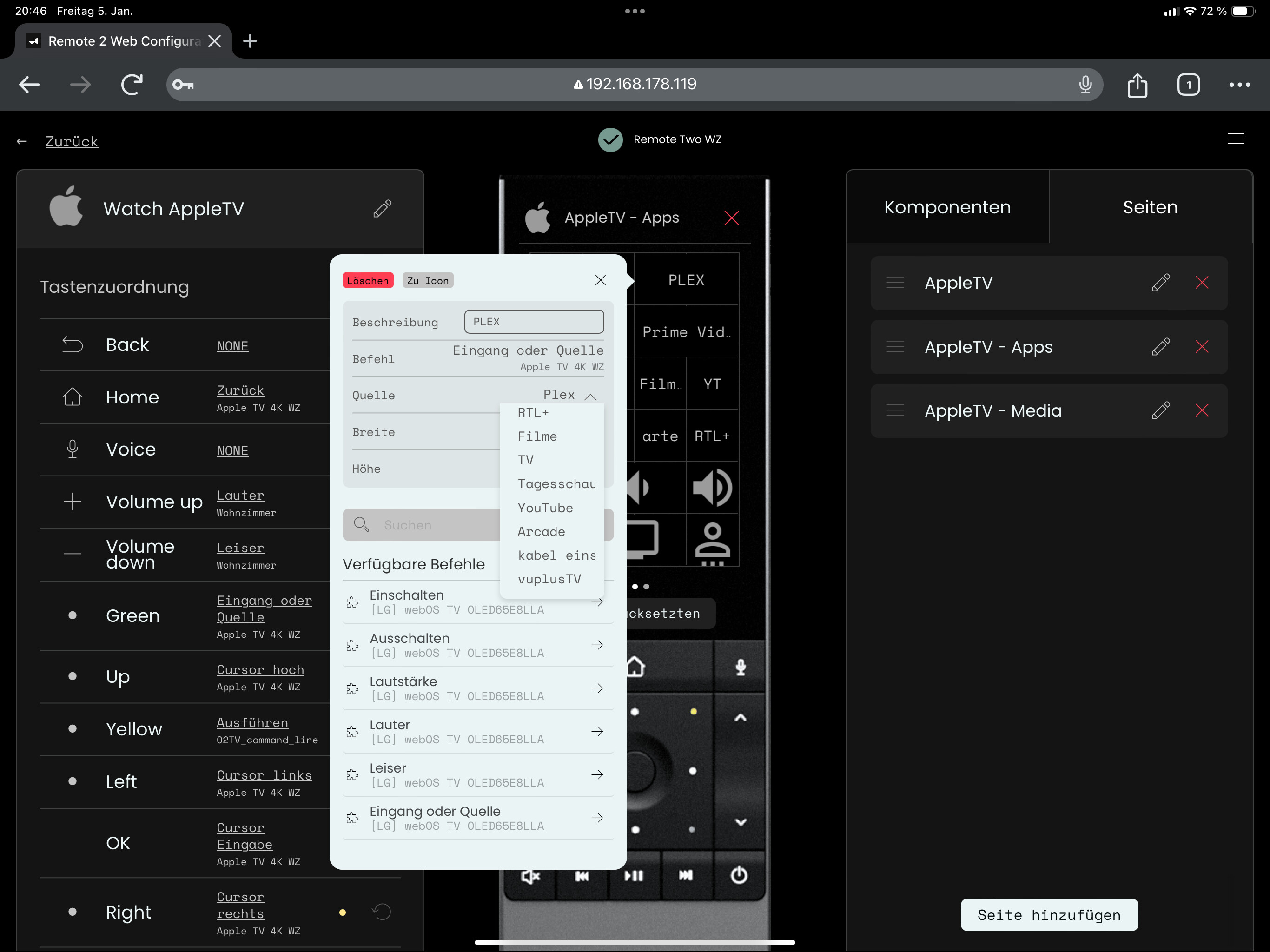

For AppleTV, the R2 core integration works, but I am using a combination of the R2 integration and the HA one so that I can have direct one-touch access to apps instead of navigating to them:
While I haven’t seen an integration for Asustor (there are ones for QNAP and Synology), what are you actually using as a media server (Emby? Plex? Jellyfin?), there are plenty of integrations for those platforms.
@WinnieandBuzz Doesn’t for me … I cannot figure out how to get that to work. I see no commands in the Web Configurator and when I use the core integration, I do not get that page with apps (I did on a previous firmware release but had to go to fix state and back to see it). Not sure how people are getting it to work which is why I’m using HA for it.
The R2 native (core) Apple TV integration has an entity “input or source” (maybe that the English name for it differs, in German it’s called “Eingang oder Quelle”) and in the field “source” (German: “Quelle”) there is a drop-down list with all the available apps.
