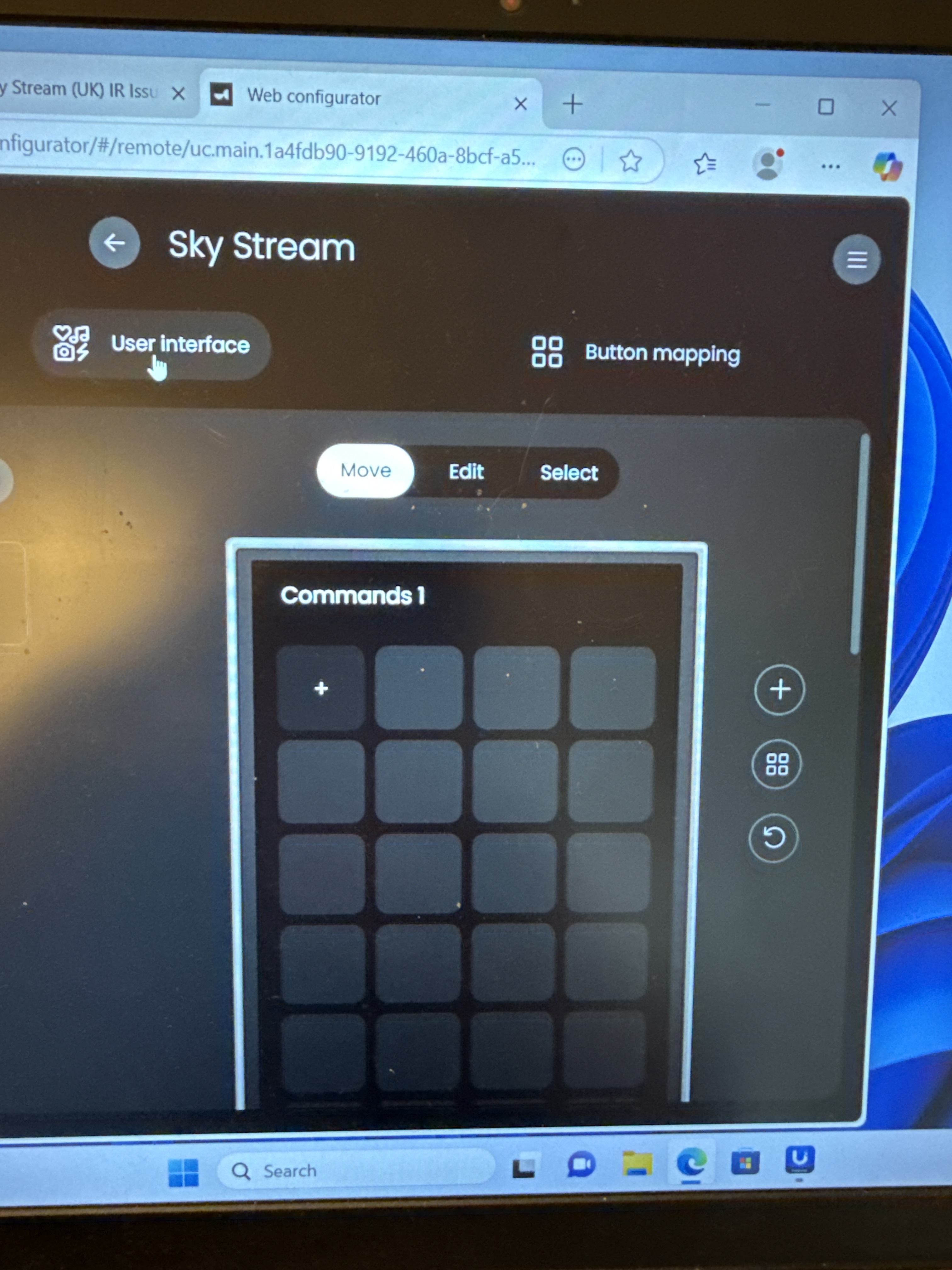

Thanks will try it, and do I create the user interface from scratch?
Not sure what you mean by User interface? You will need to create a new Infrared Entity if that’s what you mean. :+1:

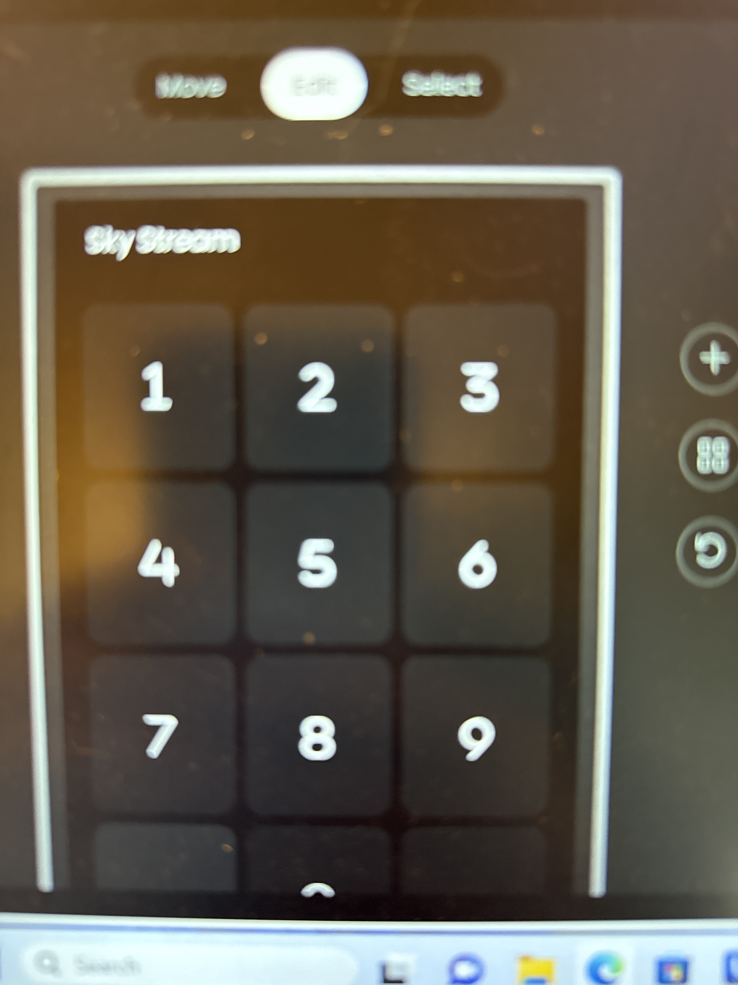

Sorry I mean this bit-
Once you’ve finished pasting in all the codes and have created the buttons, this is where you add them to the screen or map them to hard buttons in the Remote 3.

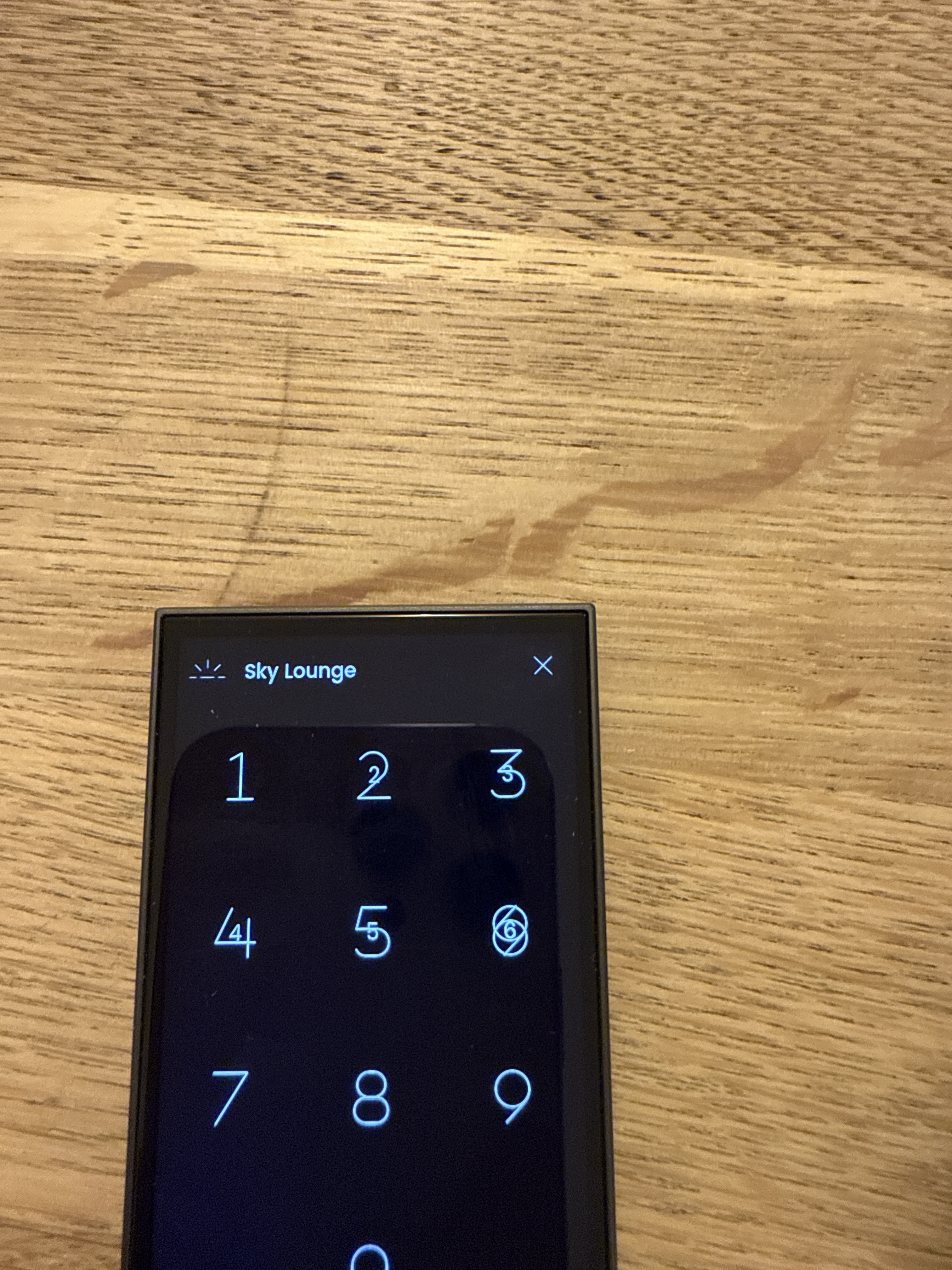

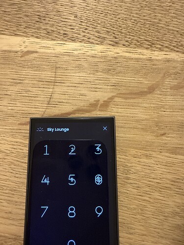

Thanks, not having much luck unfortunately. None of the commands are working and I’ve added a numpad and it looks weird! Looks fine on the configuration though.
