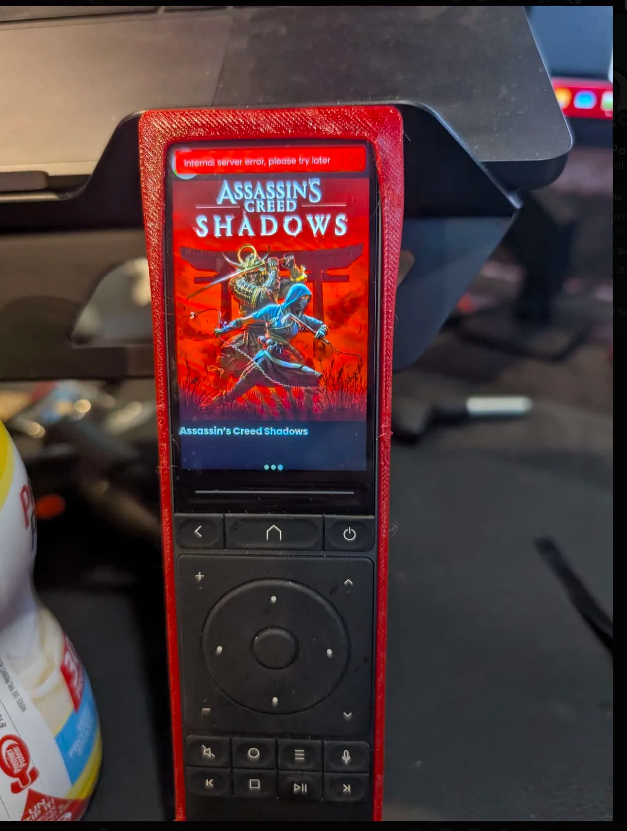

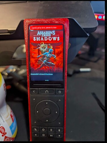

Man, that was a long day… i think i figured it out ! i need to package this up and test the final tar.gz… but its working in lab… xbox game show on the remote succesfully :slight_smile: this will be my next integration …
