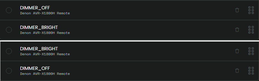

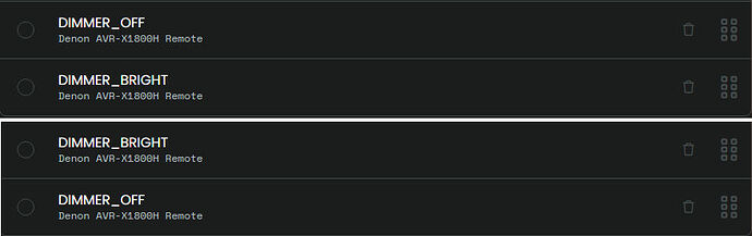

I added two commands from the Denon Remote into the radio-sequence (see picture).
But the error didn’t appear, no matter which sequence i took.
Remeber: If i use HTTP-Get, both commands are send without any problem. No matter which sequence they are.

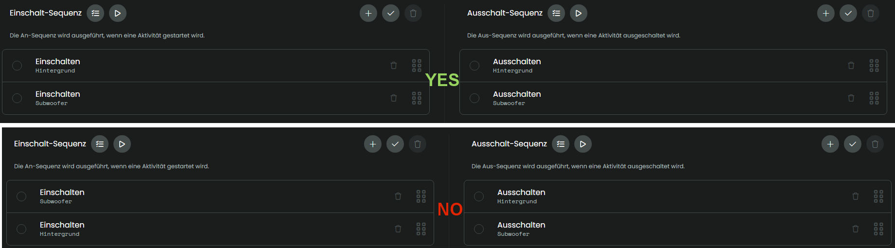

I created a new Sequence “Sequenz-Test” and only added “Hintergrund” and “Subwoofer”.
The error comes up in this activity too.

I still think this is a remote side problem as the sequence position seems to change the behavior and there are no integration errors. Can you confirm that you have 2.11.0 installed?
@kennymc.c
I don’t know how to apologize to you for the inconvenience.
The problem ultimately lays with the LM scene. With a different scene, everything works as expected.
The difference is that the scene numbers were NOT BOTH two-digit numbers. One was two-digit, the second was one-digit. Now, with two-digit scene numbers for both scenes, everything works perfectly.
I don’t know how that can lead to the problem, but apparently it is the cause of the problem.
