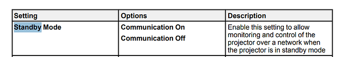

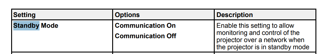

“2025-10-04 15:08:33.338935 +00:00 custom-intg-uc-intg-epson-pj INFO ERROR:projector:[LS12000] PJLink communication error on command ‘%1POWR ?’:”
This seems to be the problem. But no idea what to do. PJlink is on.
Please show entire log, not just that singular line. Need to see if integration is connected to your projector. Also, check if pjlink port not blocker on your network, make sure pjlink enabled properly etc.
Not sure how to upload here. Hope GoogleDrive is ok. Port TCP/UDP 4352 is open. Thanks for your support.
From reading the log i can see that the integration constantly try to query the projector and fail with no access , then i can see at some point you most likely turned it on physically with the physical remote, which at that point connection was established and it got an ip of 192.168.178.136 and the projector status was registered, but then projector was turned off and communication was cut. based on what i see this is either a local network issue or the projector settings are not set for “standby” mode which kill the network and shut down pjlink protocol. looking at your device manual page 113 https://files.support.epson.com/docid/cpd6/cpd61119.pdf make sure communication stay on during standby:
That’s it! I feel a bit stupid, but anyway — thank you so much!

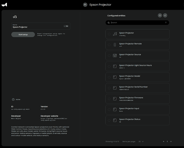

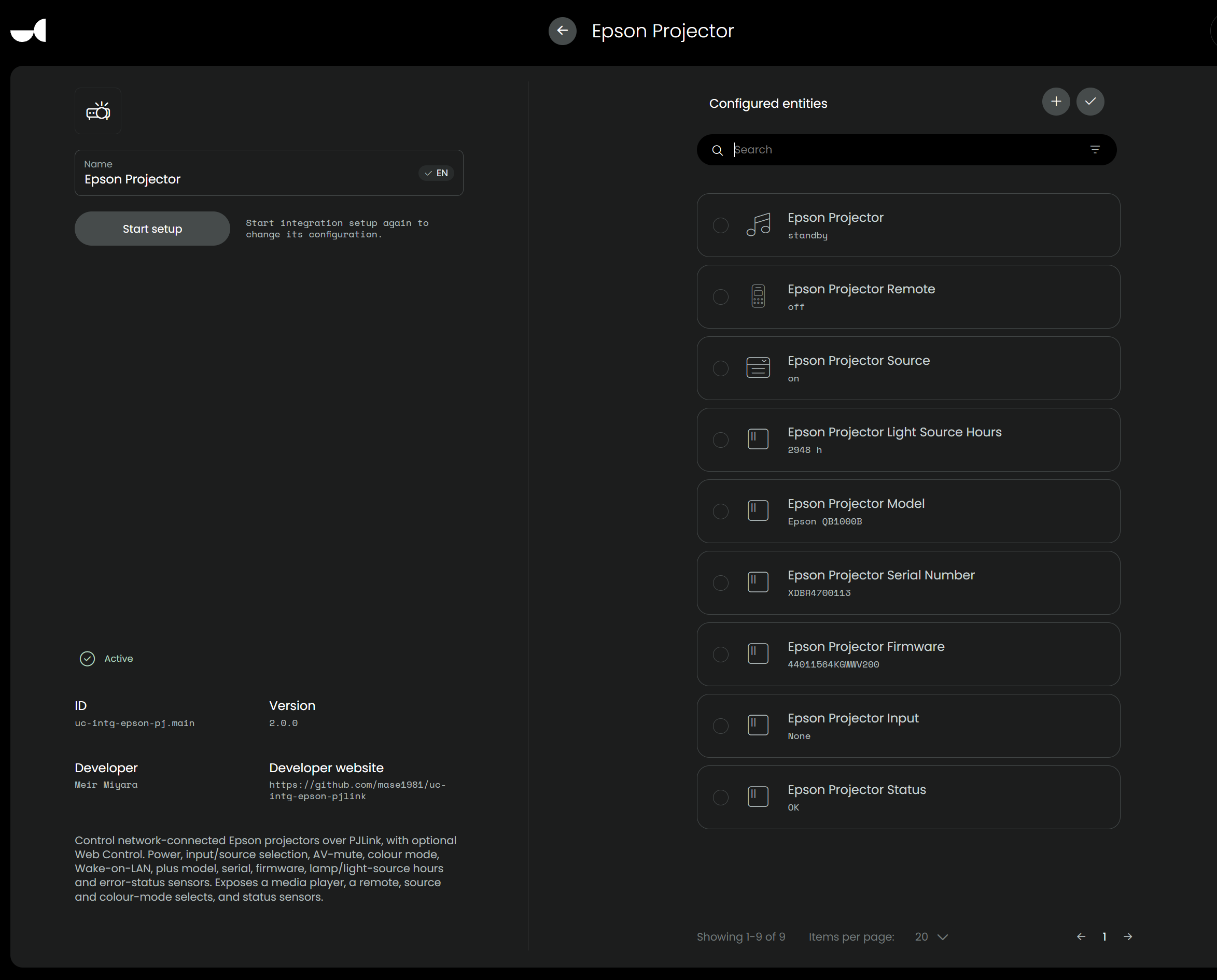

integration was completely re written to version 2.0
new sensors, remote, media player and more
