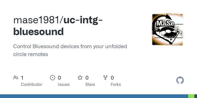

Bluesound Integration
Hey everyone, releasing my latest integration this time for Bluesound Devices.
This is a blind integration, i cannot test nor own the device. Any issue will require description of the issue, steps to replicate and integration logs. thank you.

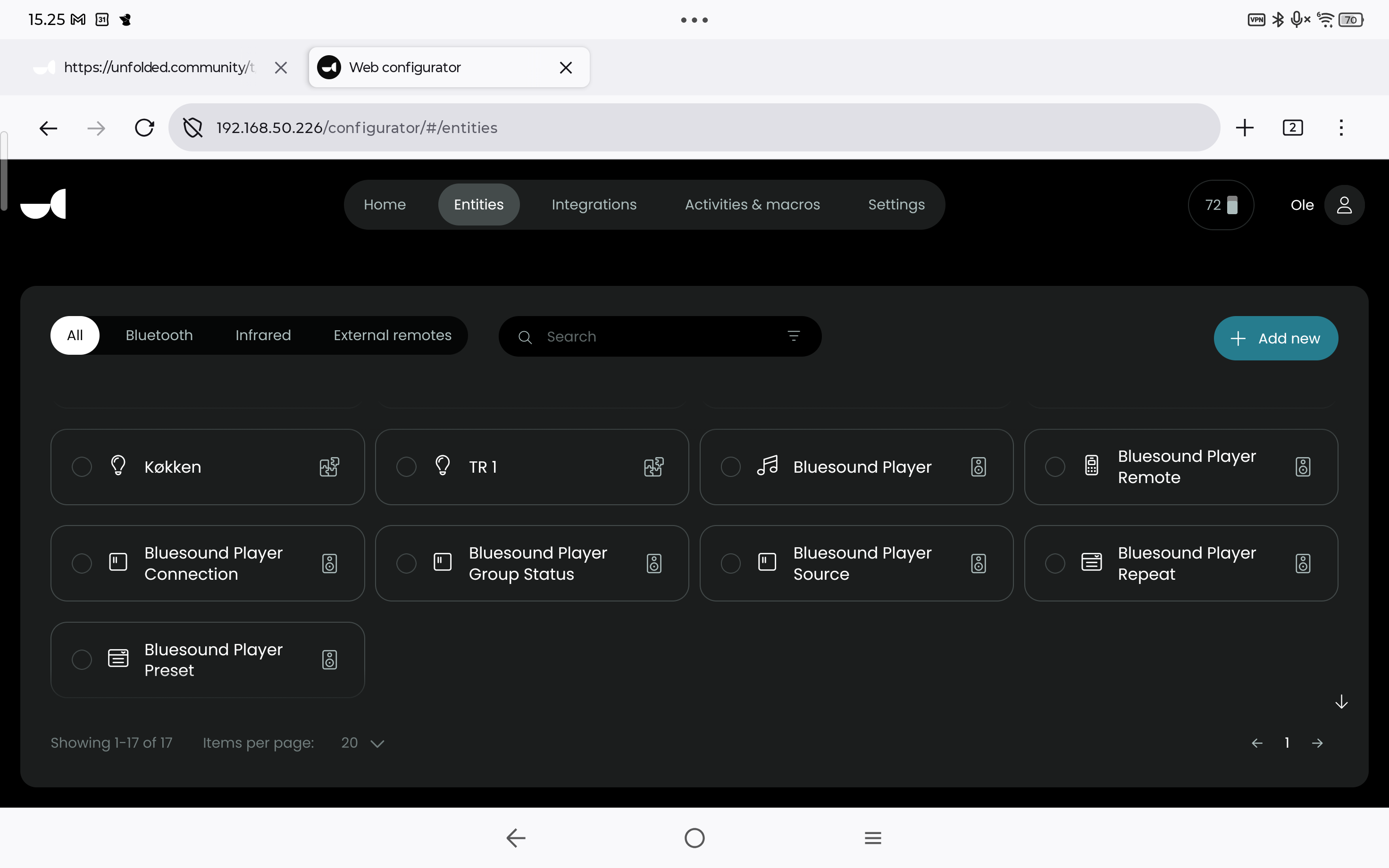

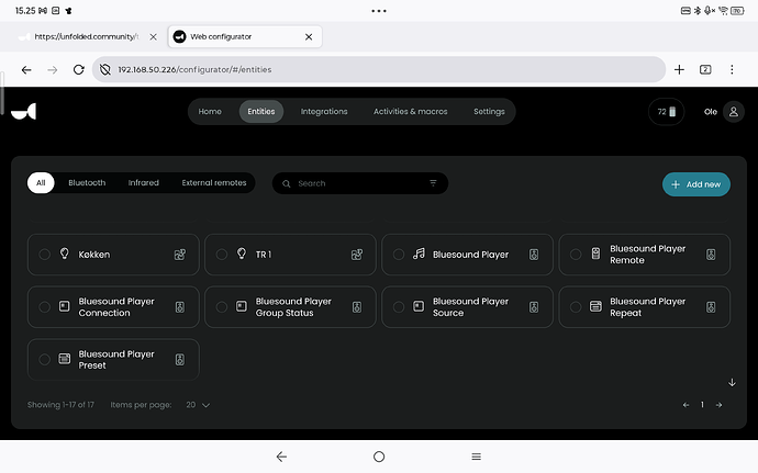

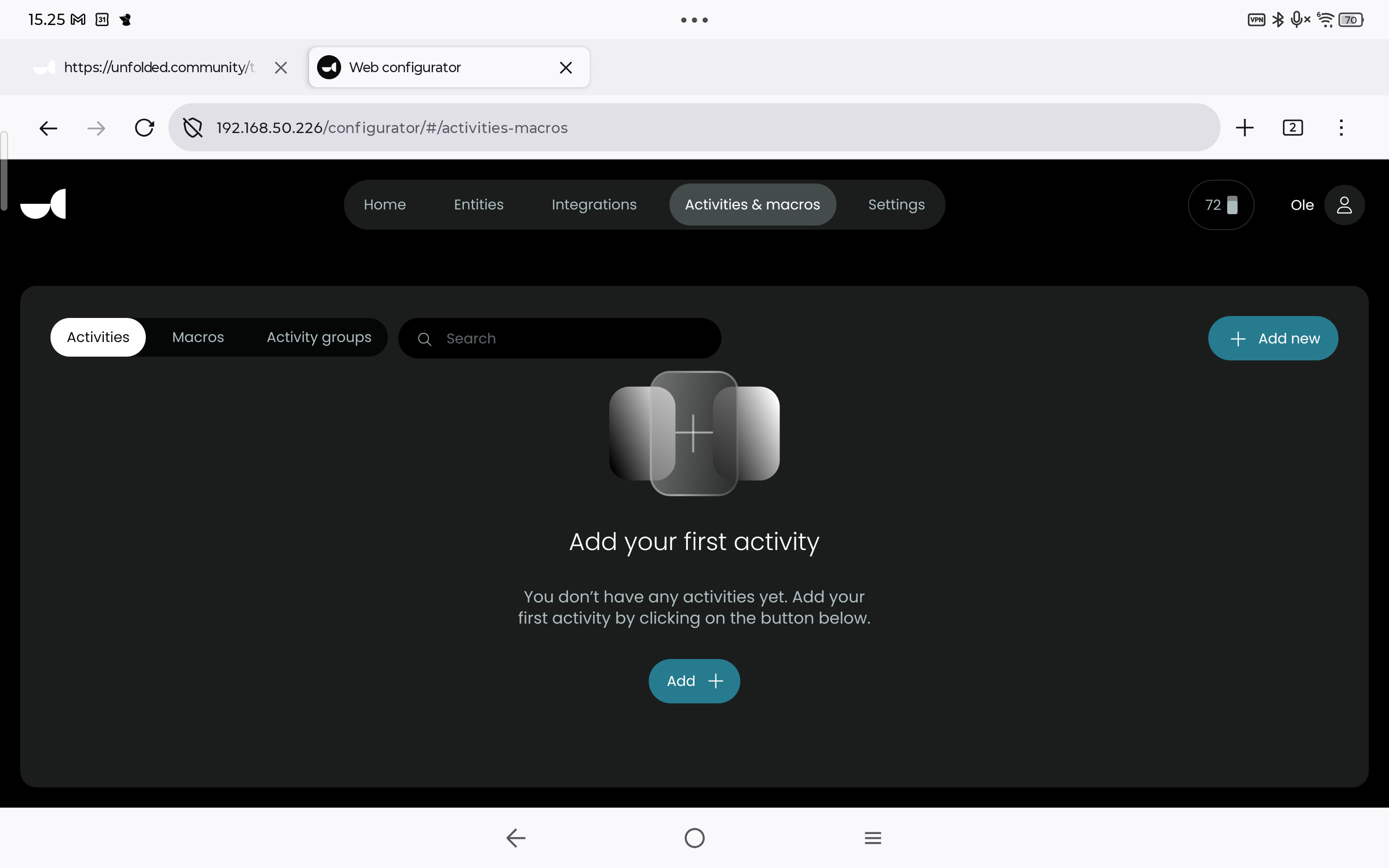

This sound more like a configuration issue…? question: are you inside an activity? did you map the volume commands properly to the physical buttons? can you share screenshots of your setup from web configurator? which entities did you add to the activity? or are you outside an activity and added the entities to a home page? if am not making any sense since you are new ot the remote , LMK.
It was working in and out of different integrations for a while. Then I left the remote for a couple of minutes and when I tried again the volume didn’t work inside Bluesound. New log here.

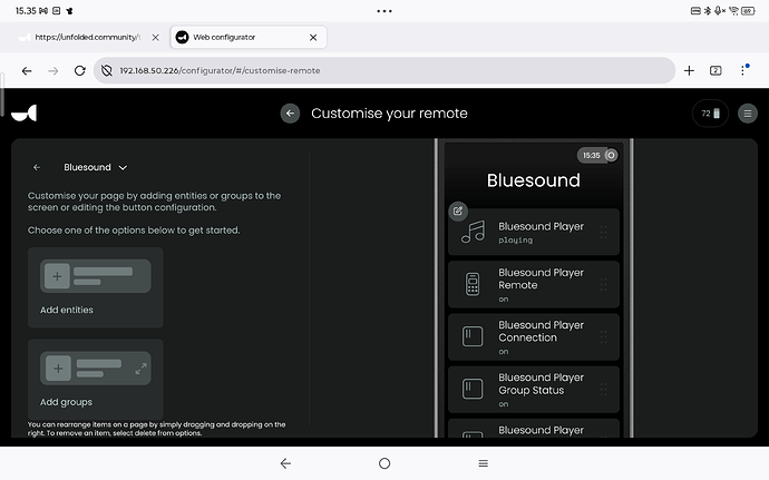

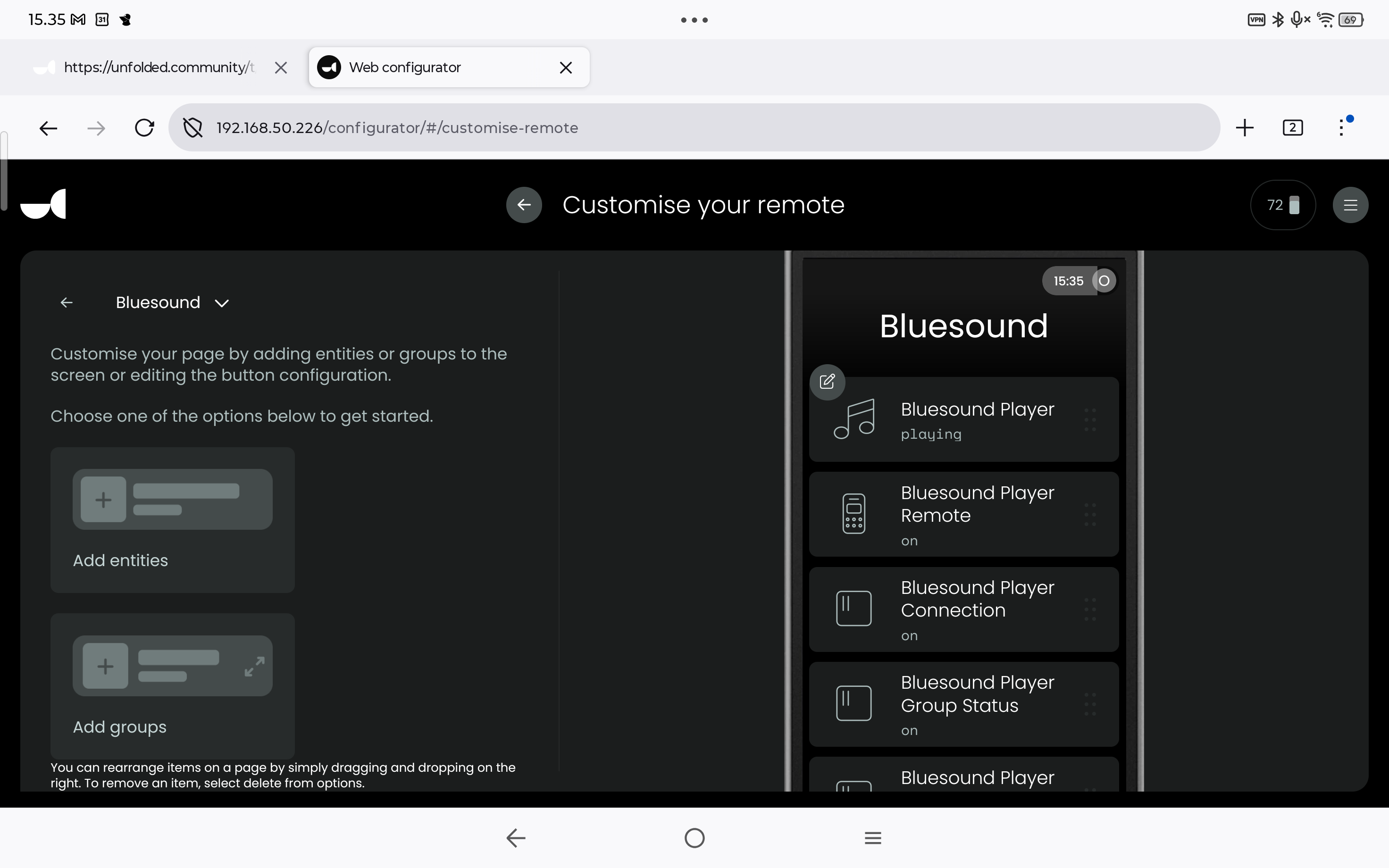

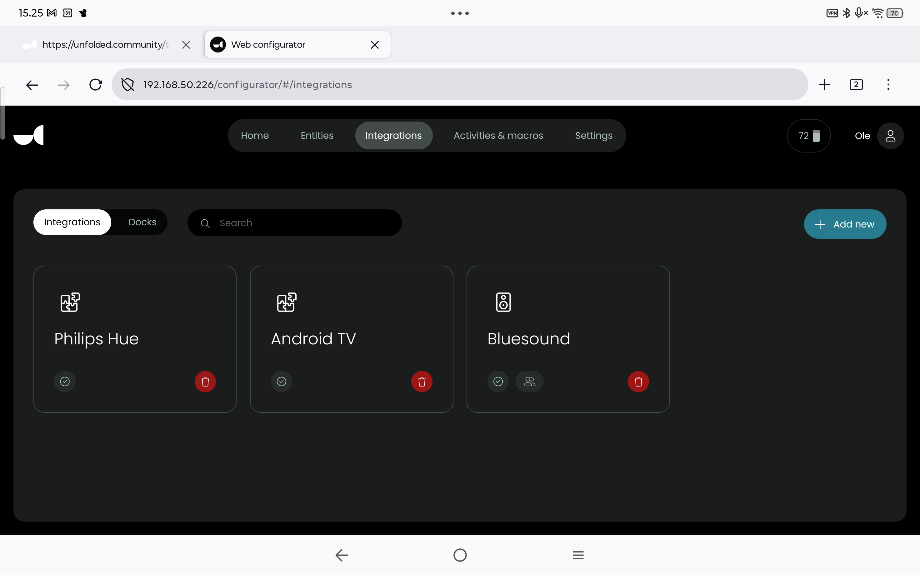

All entities on the same page on Remote.
Also I didn’t do any mapping myself. Everything is out of the box.
you have no activities, you should create an activity “Listen to BluSound” or similar, then add the entities there and map commands. watch this: https://www.youtube.com/watch?v=r2r1Pb6pOpA

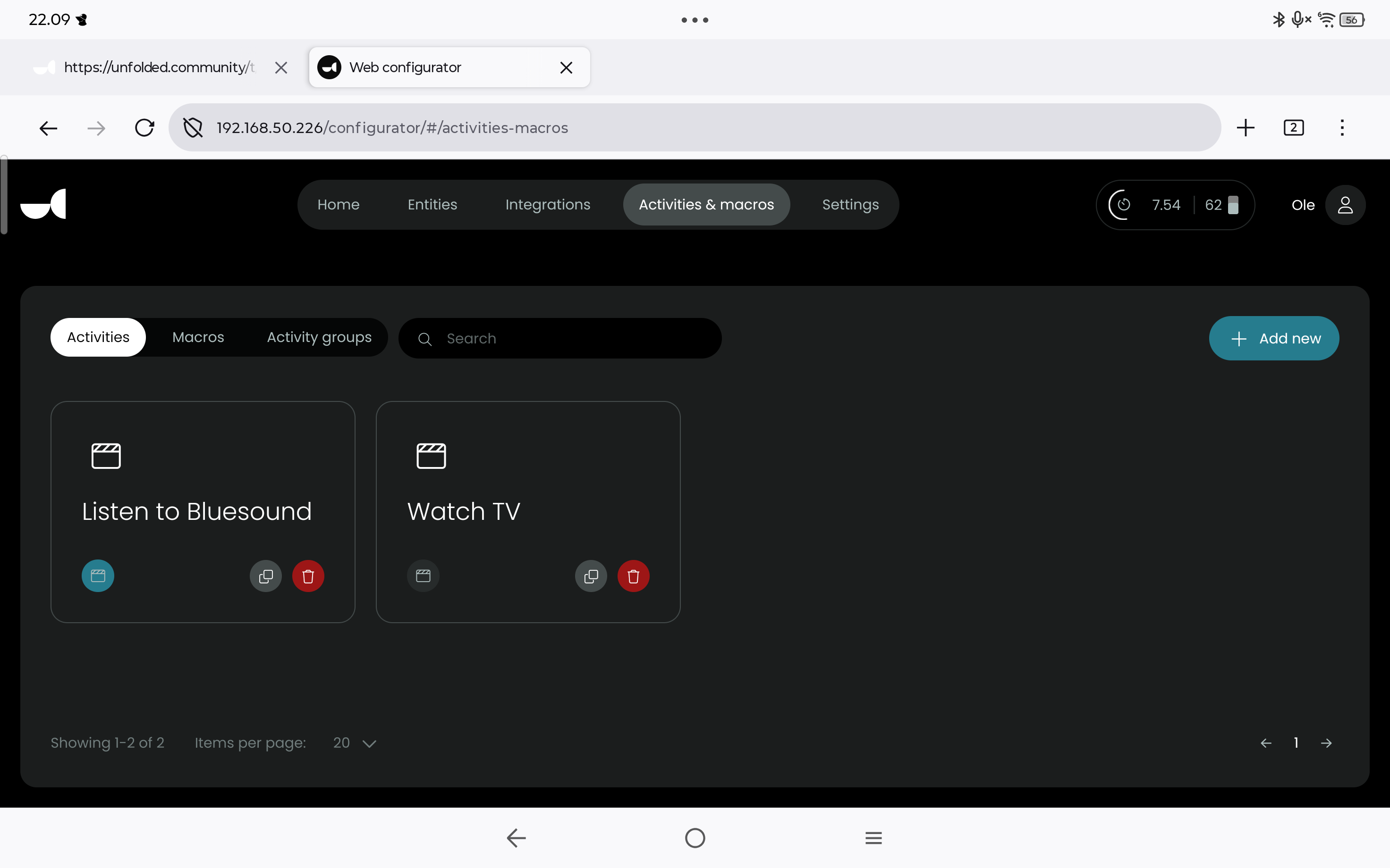

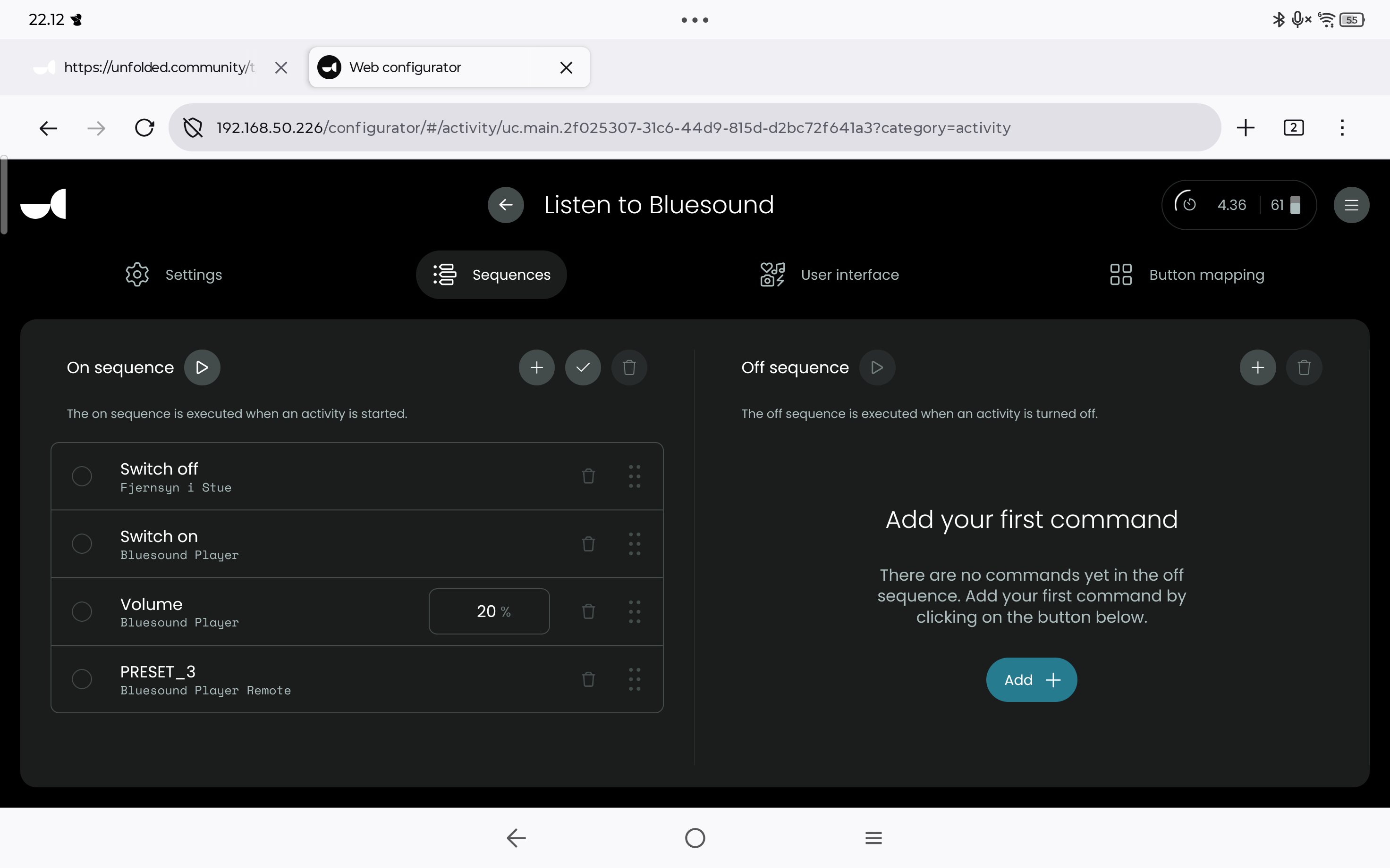

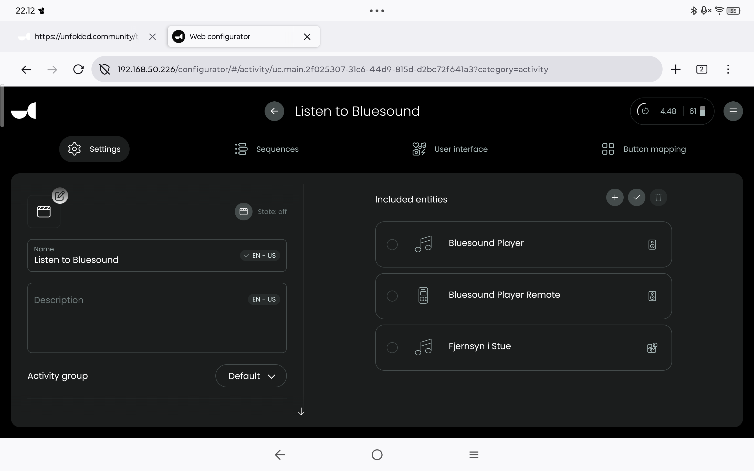

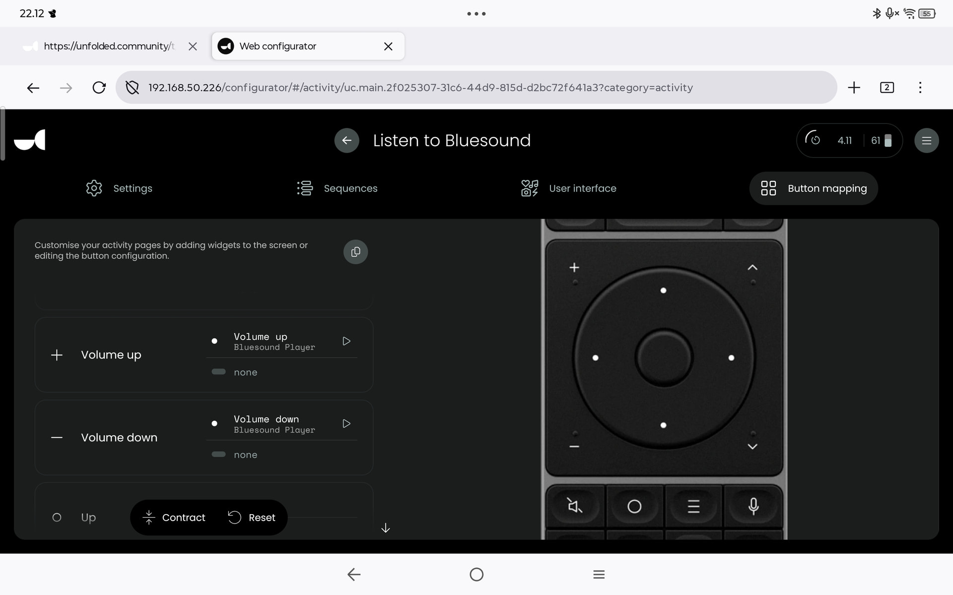

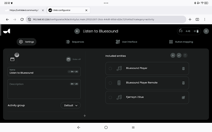

So. I created an activity. A very simple one. Still the volume gets stuck after a while - I have only seen it after remote goes to sleep - and volume doesn’t respond to key presses when waking up again. It shows current volume but nothing happens.
The activity only turns off TV (in case it’s on), selects a volume and a preset. Volume works fine initially but after sleep it gets stuck. During testing I stayed within the activity and only used volume buttons - put remote away and tried volume again after a while.
I could get things to work again after ‘Reset configuration and reconfigure’ of the Bluesound integration but only for a while. My best guess it’s that something in the configuration gets overwritten and messes with volume. Log here.
