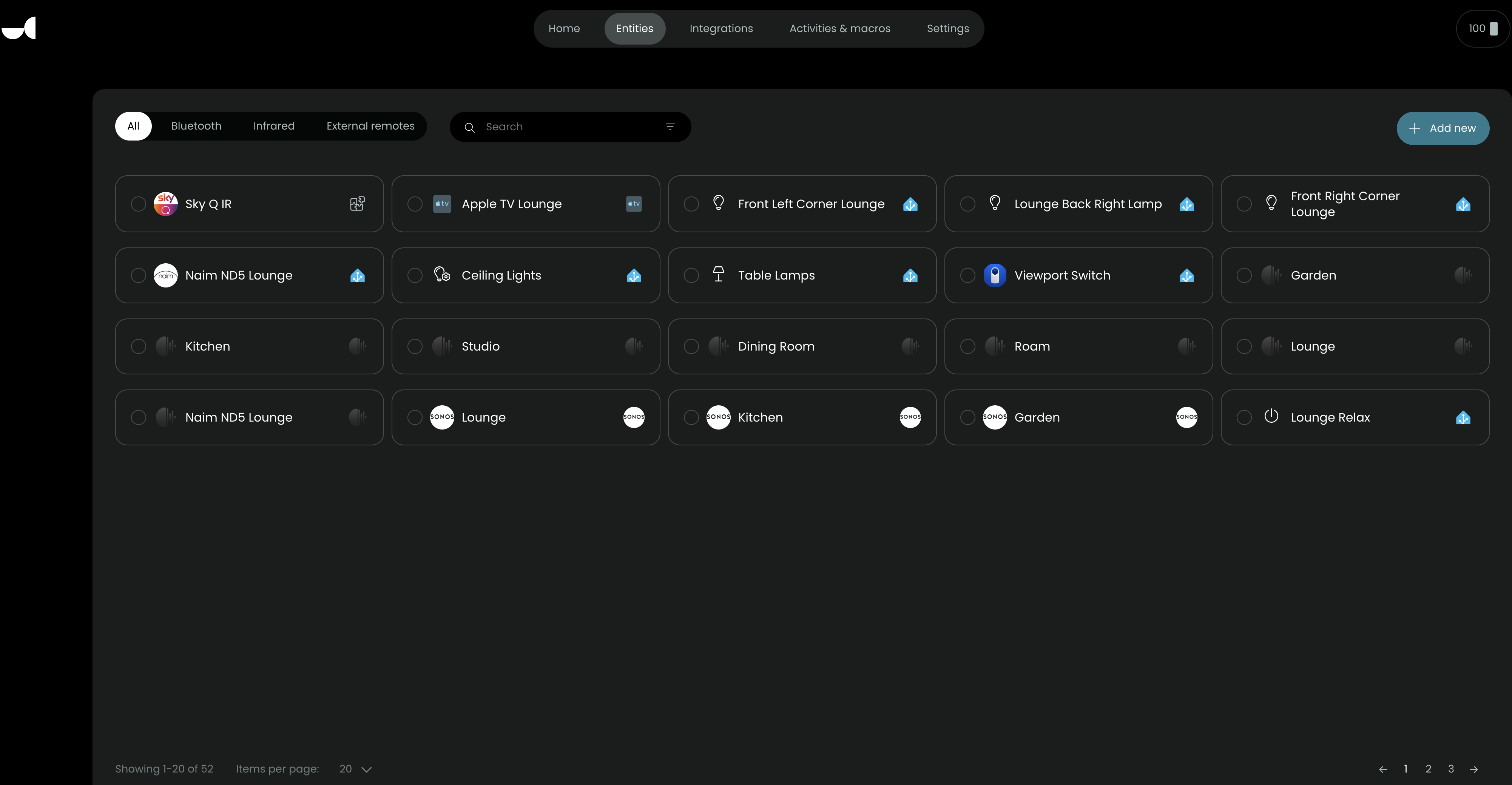

You shouldnt need to do this. When I add new entities from within the UC Integration in HA I can then immediately see these entities as available to me to add within the UC R3 Web Configurator.

OK and so you are not seeing the new entities you add in HA then added to the end of your entities page in the UC Web Configurator? When you add them in HA and you hit submit do you see the little circle revolving and then get a ‘success’ message when they sync?
Yes.

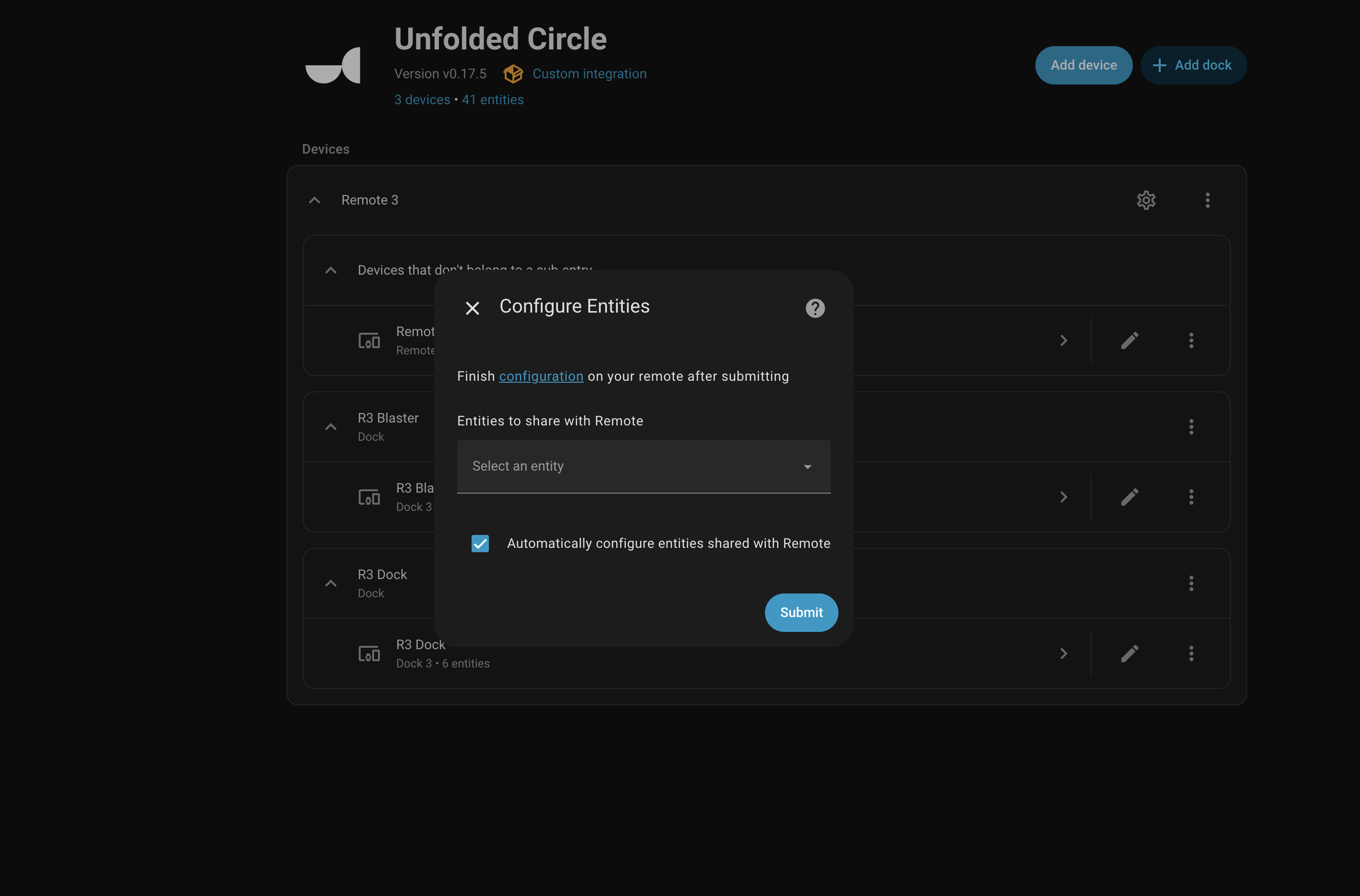

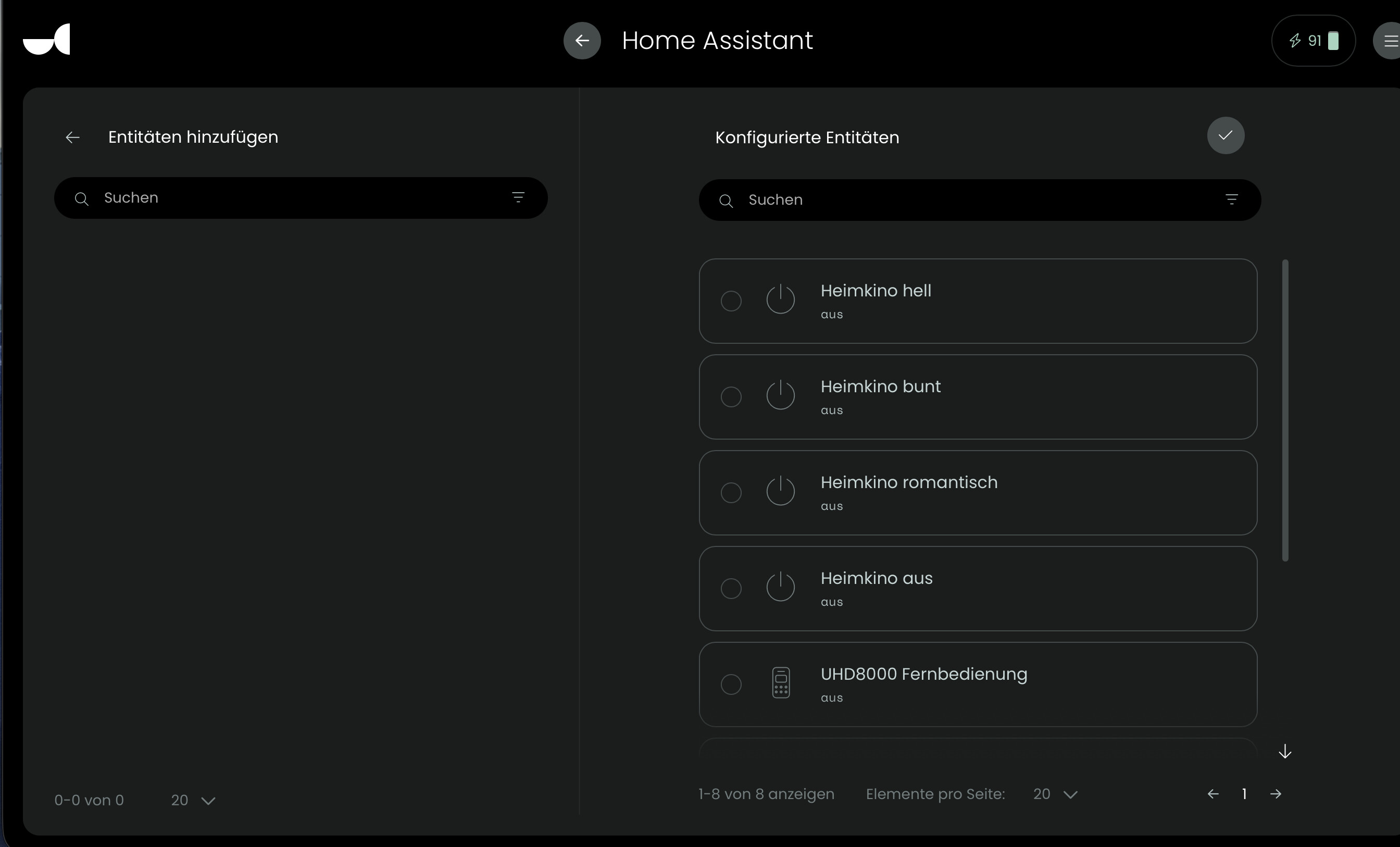

Attached 2 pics.
Picture 1: Integration works fine and I click on the plus button
Picture 2: No possibility to select new entities because there are no one.

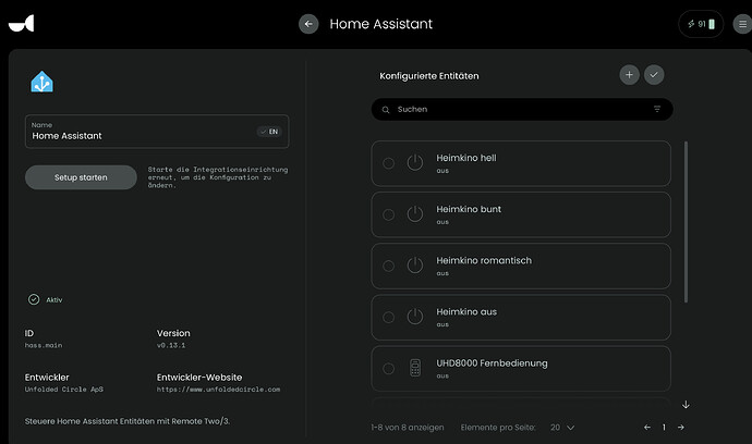

I have to delete the integration and install it again. I only see entities in the first time.
And I tried also the “start setup” button. But also no entities to select.
You add the entities you want to see in Home Assistant itself (not the integration within UC) and then they will appear in the UC Web Configurator without you having to rerun the home assistant integration in UC.
Oh man, that’s it… very nice to know.
Thank you, that works fine!
