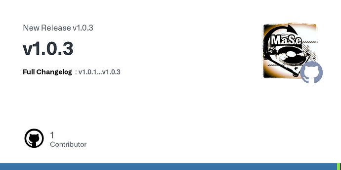

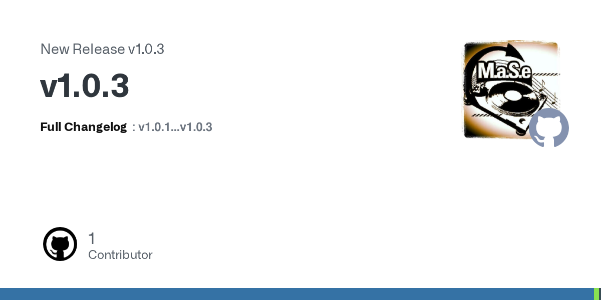

ok, i also just added multi device support, but i cant test. if you can, will be helpful. find me on discord in the unfolded channel or send me a DM.
just released a multi device support version, i am unable to test as i do not own a muiscicast device but hopefully it works, if not - please LMK
