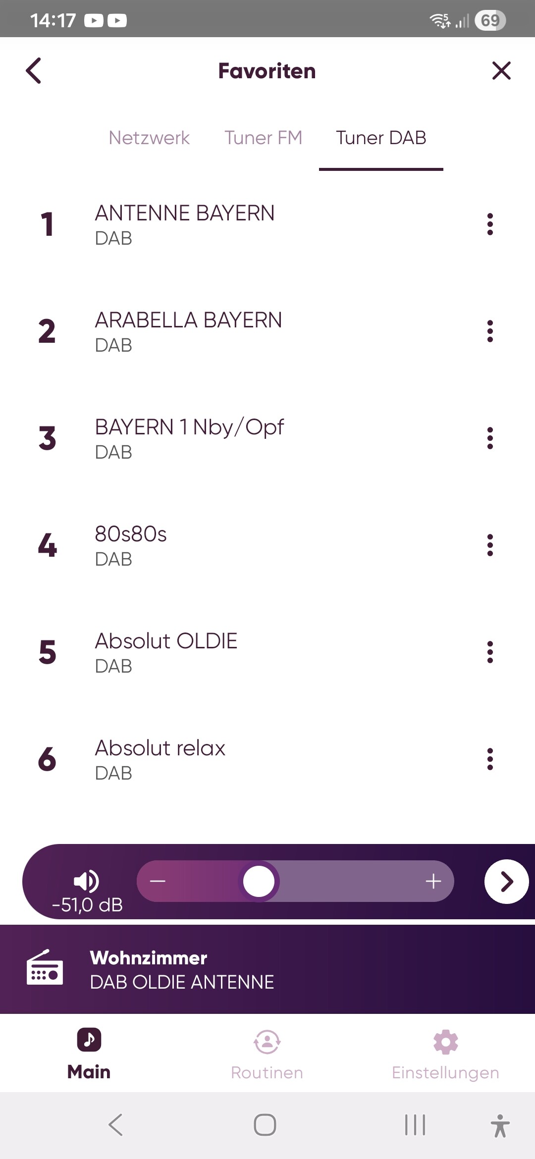

I just tested the latest version. So far it works fine. The only integration I missed is the other type of favourites. In Musicast I see 3 different types: the net Radio fabs (which are implemented), the tuner FM favs and the tuner dab favs. Would it be possible to add the others as well?

hi, as i do not own a yamaha device and i built this blindly for everyone, i need more information, please read the instructions and run the discovery script and provide logs so i can learn and see more what is happening on the backend to see if i can add any enhancements. without it, since i do not own the device, i will not be able to.
Thank you @Hartmut for providing the API endpoints. New version is up with a lot more functions.

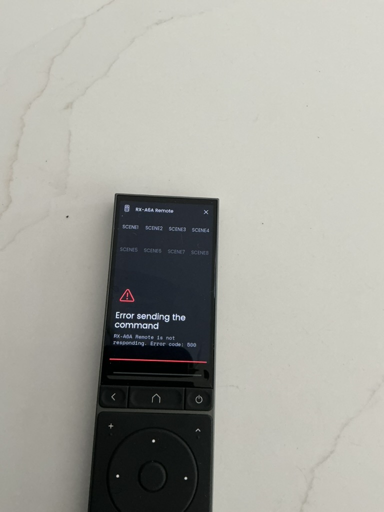

Hi @M.a.S.e - I tried the MusicCast integration today. For the most part, it looks great! But I think there may be an issue with the Scene selection buttons.
If it is helpful, I am able to control scenes in Home Assistant using CURL with this endpoint:
/YamahaExtendedControl/v1/main/recallScene?num=1
/YamahaExtendedControl/v1/main/recallScene?num=2
/YamahaExtendedControl/v1/main/recallScene?num=etc….
Hey, come to discord - share the logs and thank you for sending the commands, if they are missing in my code will be easy to add them. send me logs for review (replicate and send logs). discord is better for comms. thank you.
