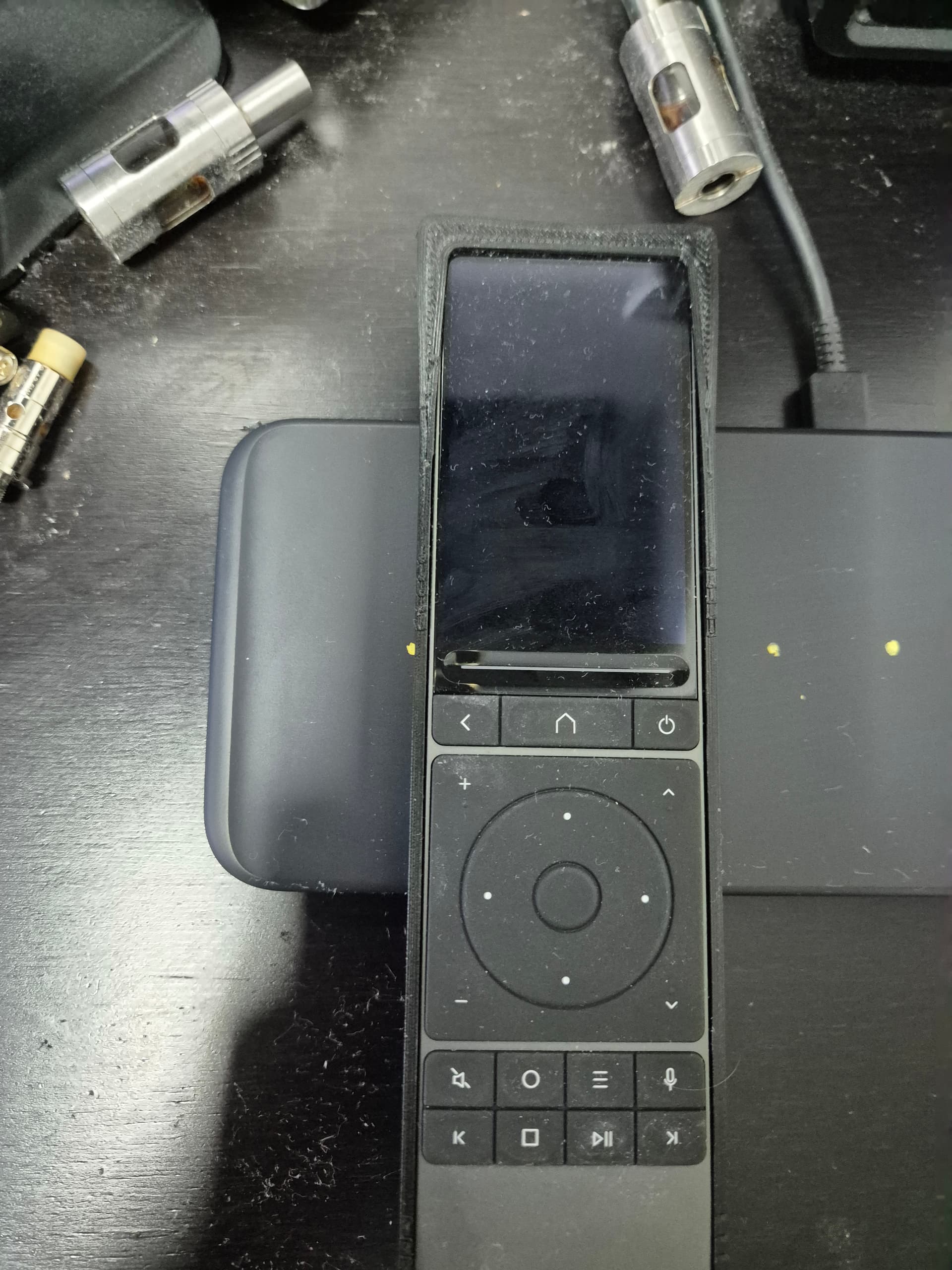

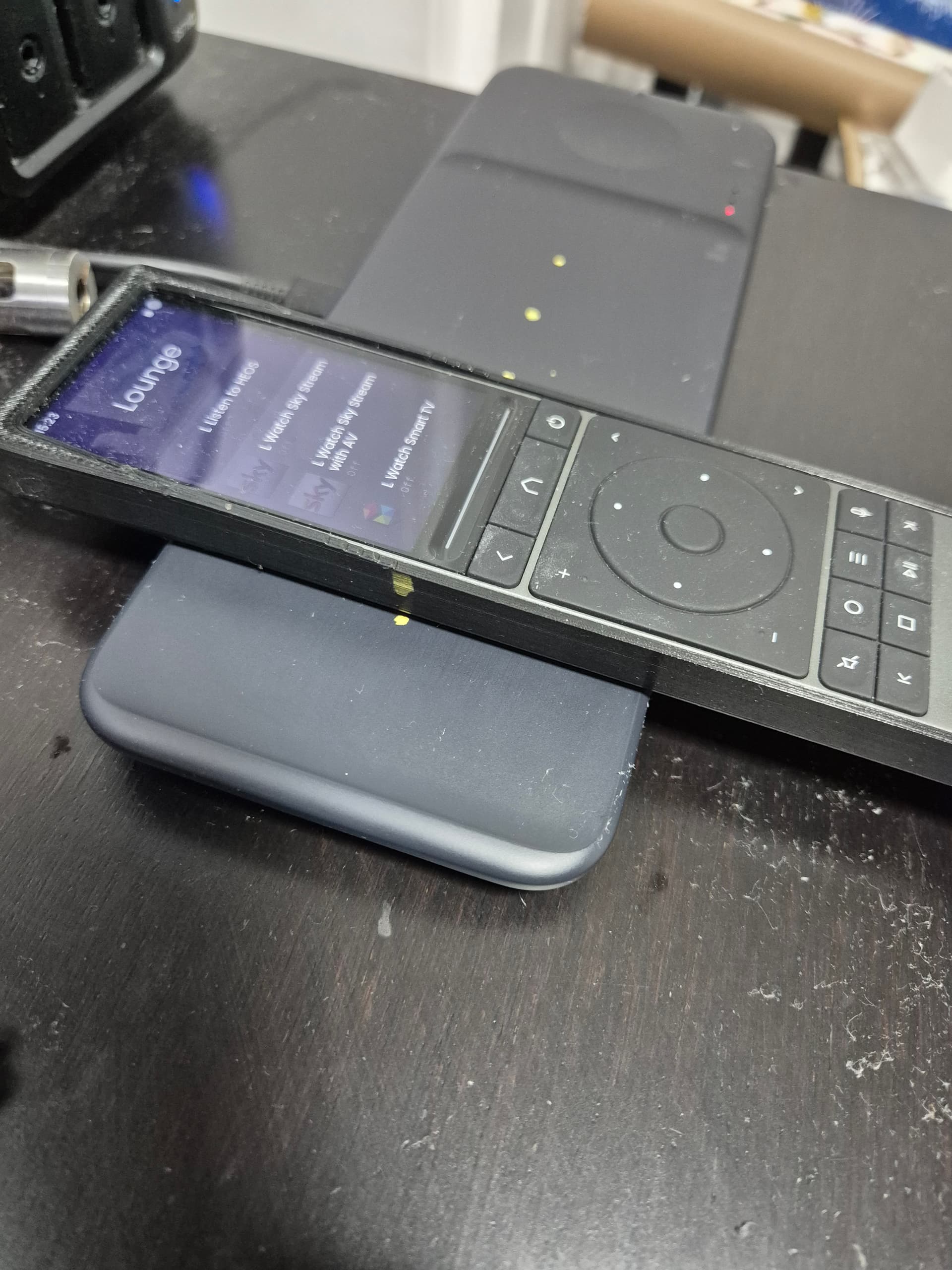

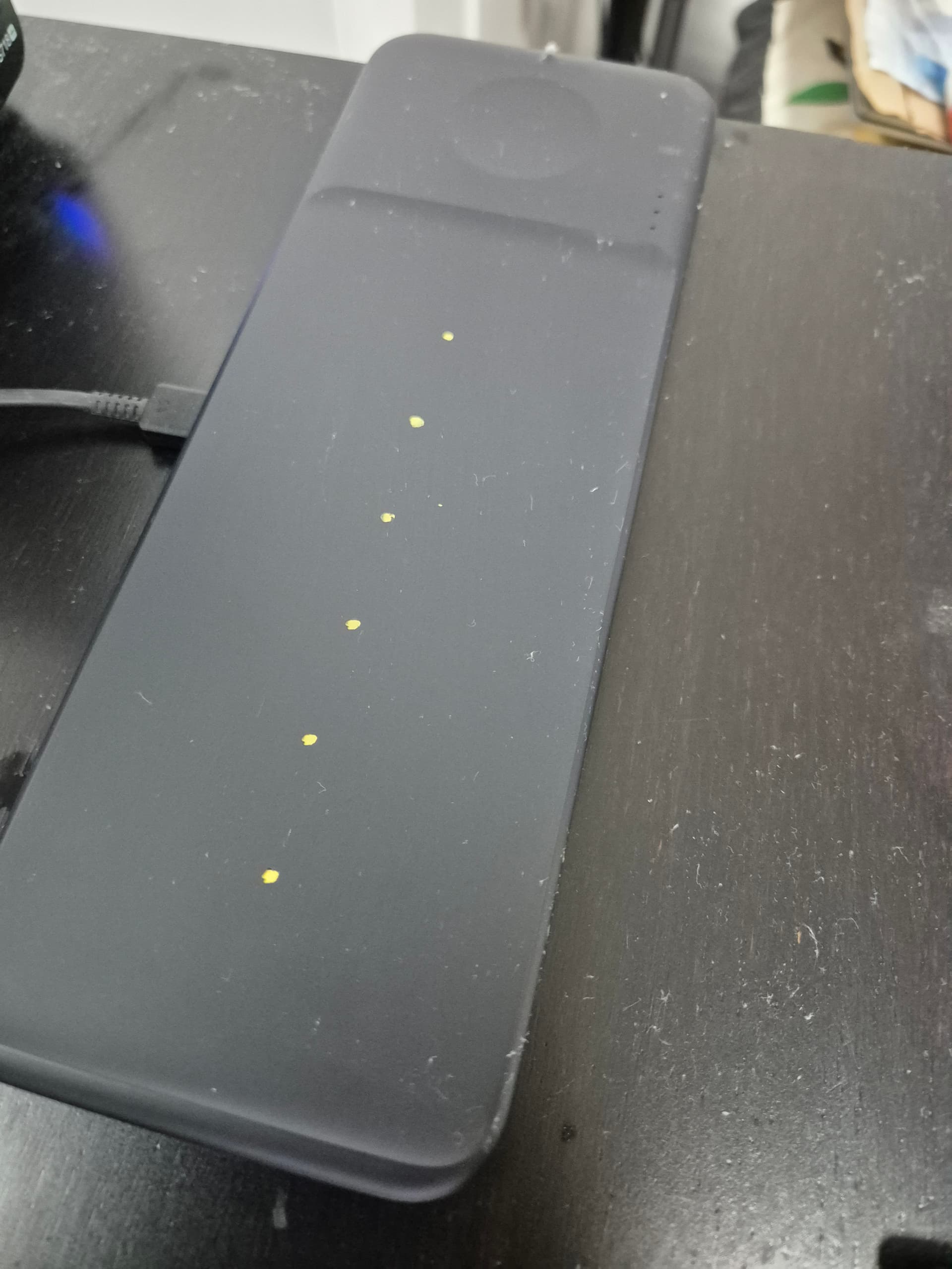

I’m also using a Samsung Trio wireless charger. I used a paint pen to highlight the black positioning dots on the charger and also put a mark on my R3 cover to enable accurate placement on the charger. This is in my office and I have another Trio in my lounge
