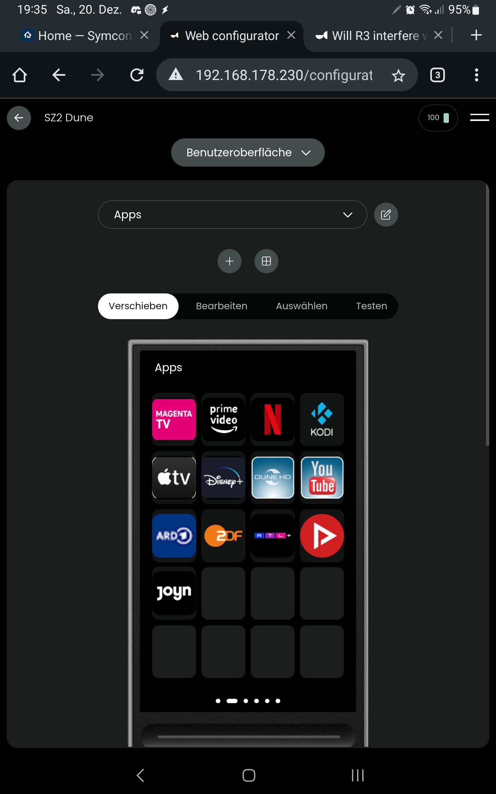

Btw. R2/R3 without pictures is no fun

Btw. Pictures are stored in a backup and restored also on a R3. So you can hardly mess up your programming by using pictures. Like in usage of a computer “no backup = no mercy".
