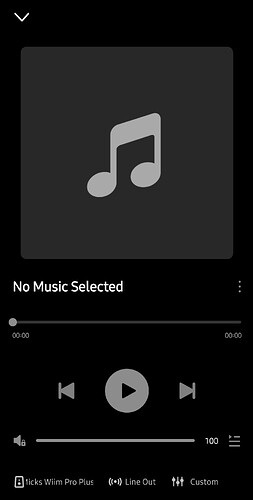

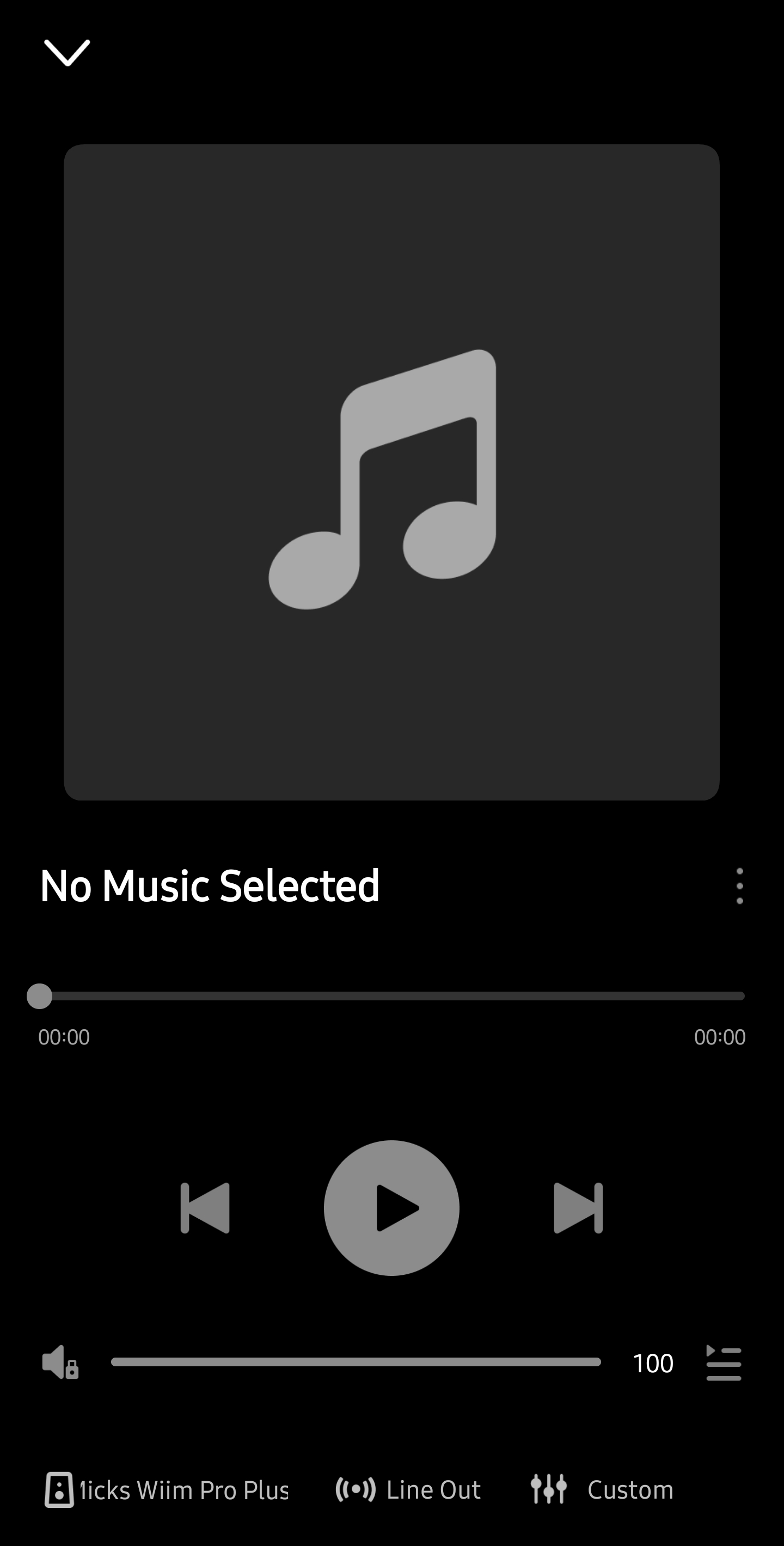

…and I have another question. I use the WIIM with two different outputs, optical and line out, but I can’t find any option to define the outputs. It seems like only the inputs are defined.

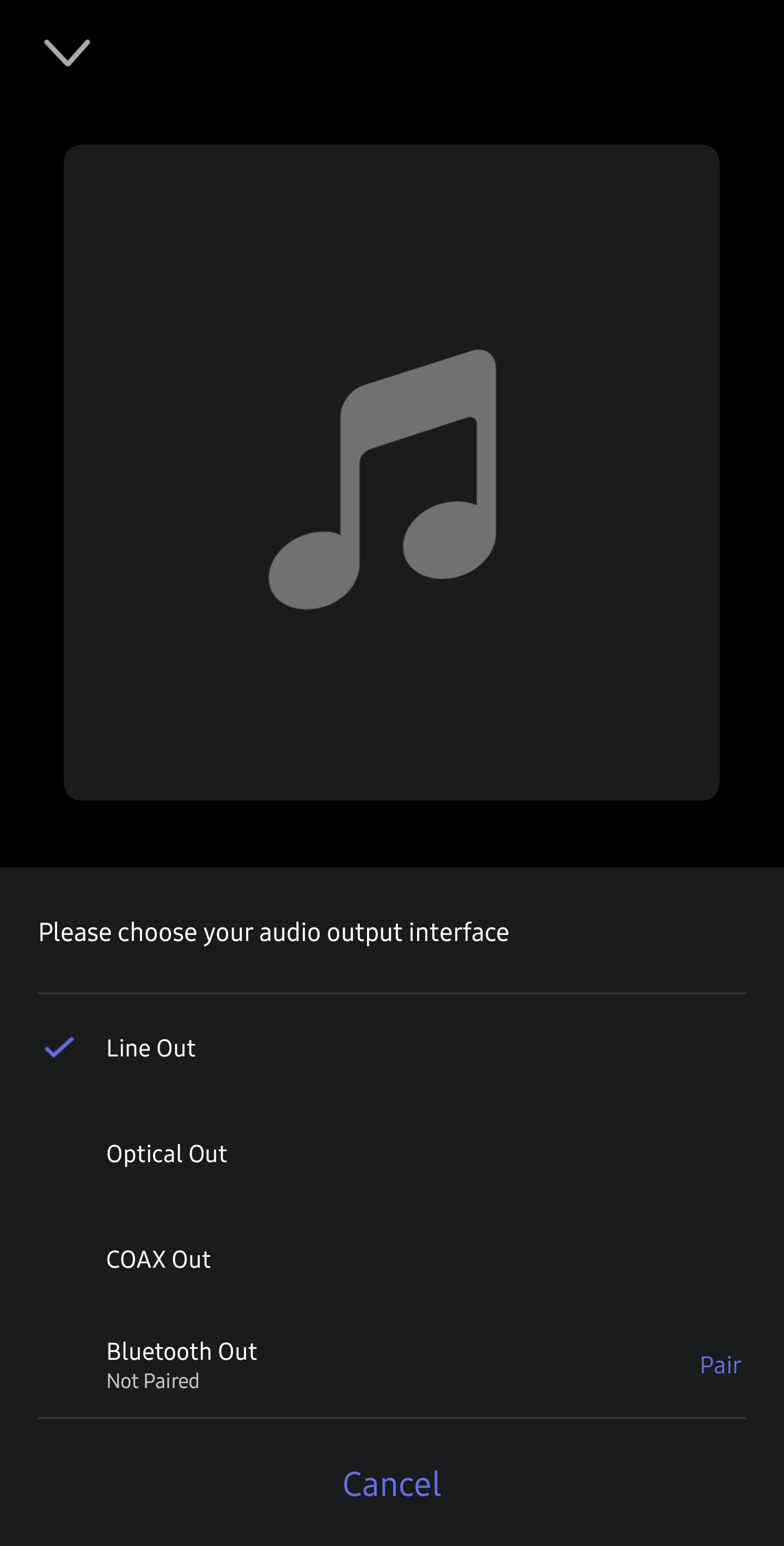

No, I don’t use them at the same time and I think, that wouldn’t work at all. The WIIM provides the music signal to my AVR via line out in the living room. There is another connection via optical out to a pair of active speakers in the dining room. So I switch between the two activities. The output can be set in the app. (see bottom line)

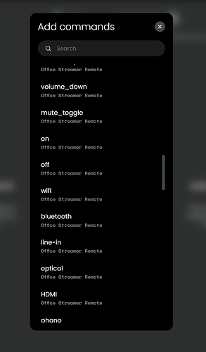

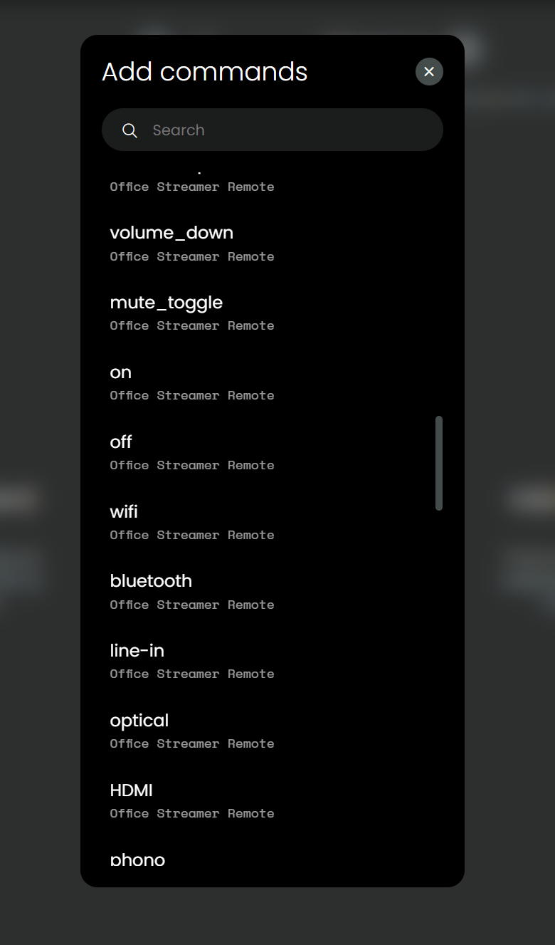

I’m not understanding what is the issue you trying to report. Are you saying on the remote entity you don’t see the output options on the remote entity? Send image of your remote after your add the remote entity (not the media player). You should have a button for all outputs to choose from. I developed this on the ultra and I see all output options and can toggle them all

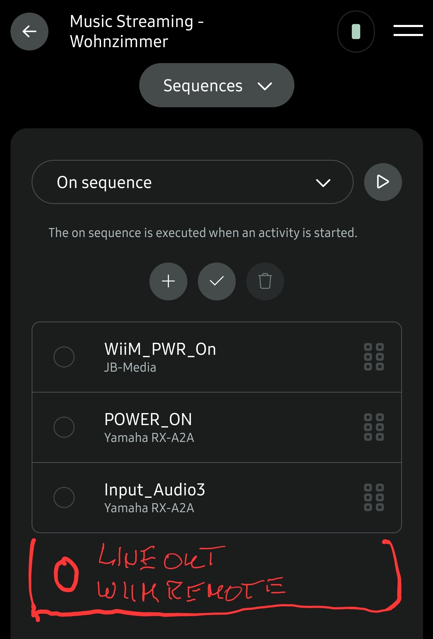

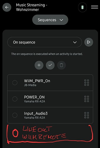

I have two activities. For one, I need the music output of the WIIM in the start sequence to be set to “line out” for the other to “optical out”. But there is no line out to choose. I can choose two times “line-in”. What is this for?
got it, looking into this now.
try this version, it should add options to choose during an activity setup: Release v1.0.2 · mase1981/uc-intg-wiim · GitHub
OK, thanks!
Two questions. That is the setting exactly called? Line out? I ask, because it is not visible in your screenshot.
Secondly, if I want to update to 1.0.2, do I have to remove the 1.0.1 before? It can I just install it, and it recognizes it, that it is an update?
try line in, if that works i just made a spelling mistake.
