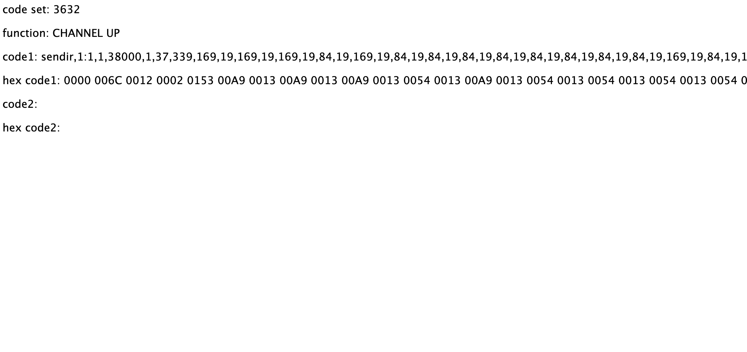

Hello - I am having trouble getting my DVR into UC. My Remote 3 will only learn some IR codes. Process seems buggy. Does anyone have a source to get the IR codes for the individual buttons? Thank you

I have a Frontier (originally Verizon) FIOS DVR and I was able to get the IR codes from
Global Caché Control Tower
Register on the web site (very easy) and then search for “Arris VMS” or “Arris Moxi”. Between the two of them I was able to get the IR codes for all my DVR’s functions. I didn’t make a batch file but just copied and pasted individual codes. Its been a long time since I did it but I think the IR code is the sequence of 4 character strings between two “ characters.
Good luck,
Gerry
Thank you Gerry. Will check it out
Just for clarification. Do I post just the Hex Code 1 string?
Thank you
fdemello:
Like I said it’s been a long time since I did it but I’m pretty sure it’s the hex code sequence with all the 4 character strings. But make sure you get the entire sequence that is between “ character.
Good luck,
Gerry
fdemello:
Additionally, if you get a single code then I don’t think there are “ characters. It would then be just identified as hex code.
If you register on the site you can download entire code sets and then the hex codes would have “ at the beginning and end.
Gerry
