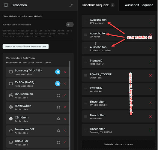

Hi, I posted a short guide on Discord a couple of weeks ago that might answer some of the questions - so I will repost it here:
So, the result is that if you are running an active activity (e.g. Watch TV) you will be able to just start another activity from the start screen (e.g. Watch DVD). As in the off sequence within the activity only the "core devices (e.g. cable receiver) will be switched off, the on sequence of the other activity will make sure that additionally required devices (e.g. DVD player) is going to be switched on (and respective inputs will be switched according to "on sequence) The former active activity will be set to OFF (as it ran through its “off Sequence”. If you want to switch everything active off - you can simply use the physical “Off Button” within the active activity - this will - according to the defined sequence in the Macro - activate the off sequence for the active activity (e.g. DVD player off) but also send the commands for the general devices directly (like TV and Amplifier)
This way you can really create a great way of handling grouped stacks of devices.
Here the sample for an “off” Macro - 1. Notice: see the cable receiver I use to watch TV is not part of the off macro
The “on sequence” for one of the activities
