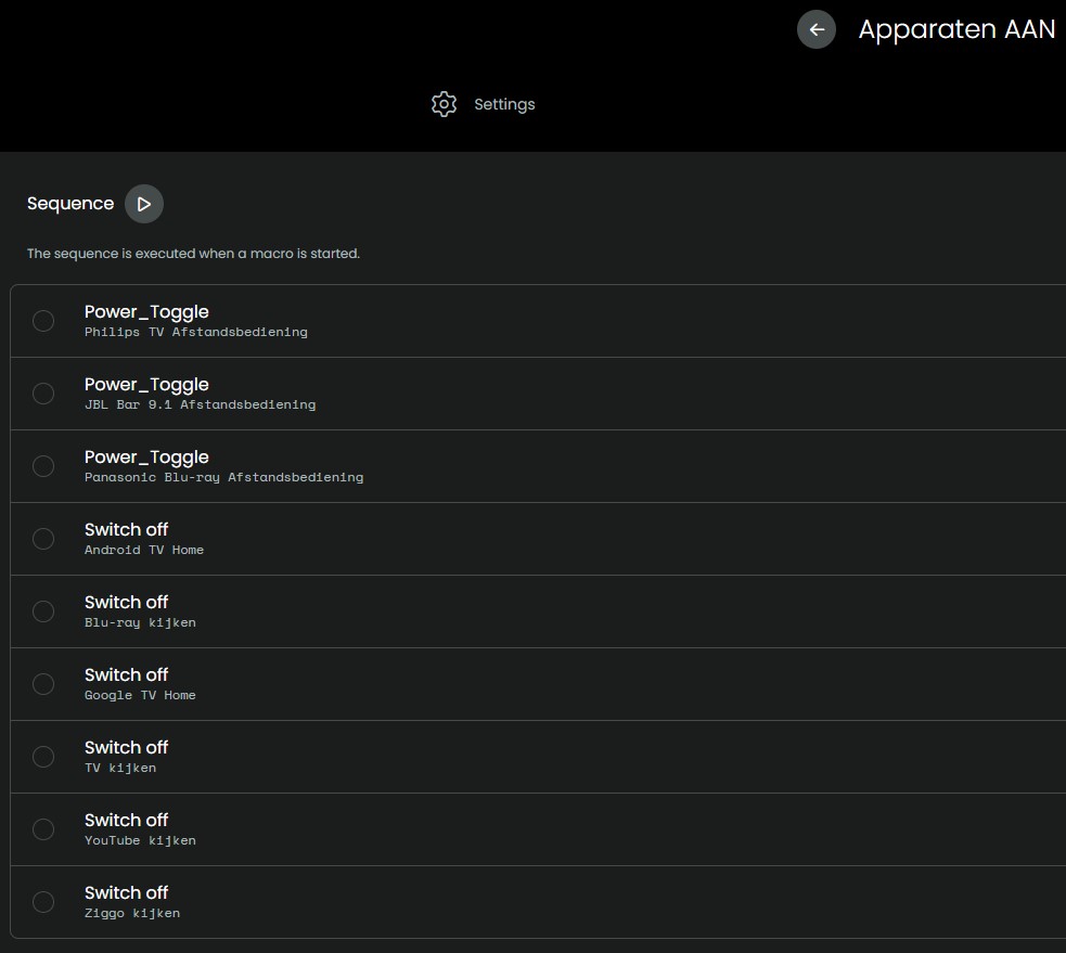

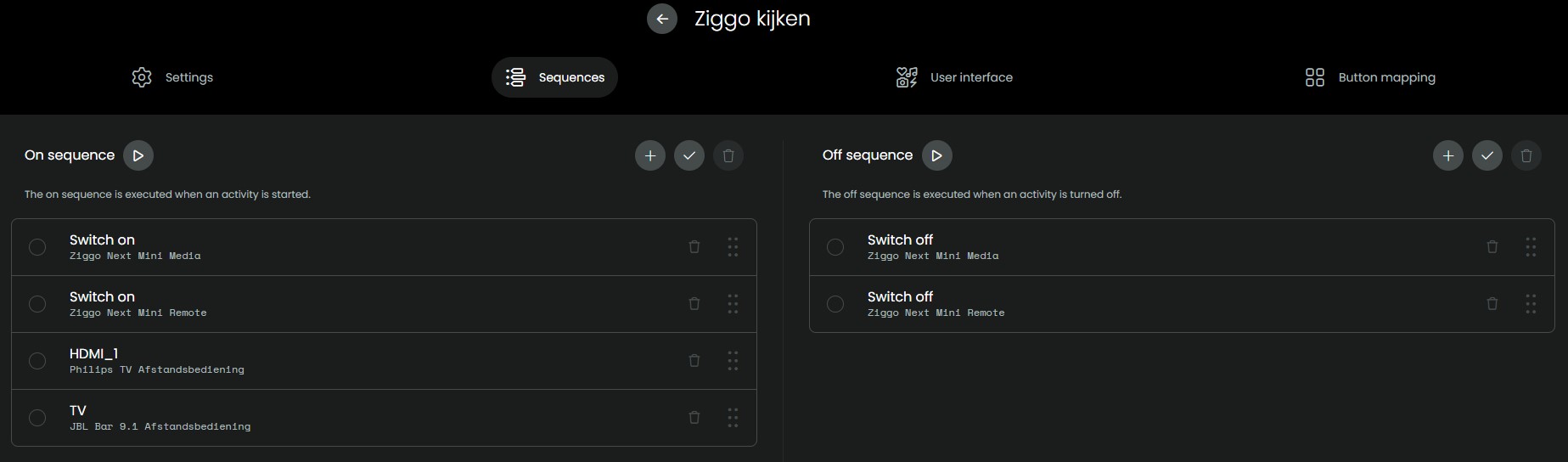

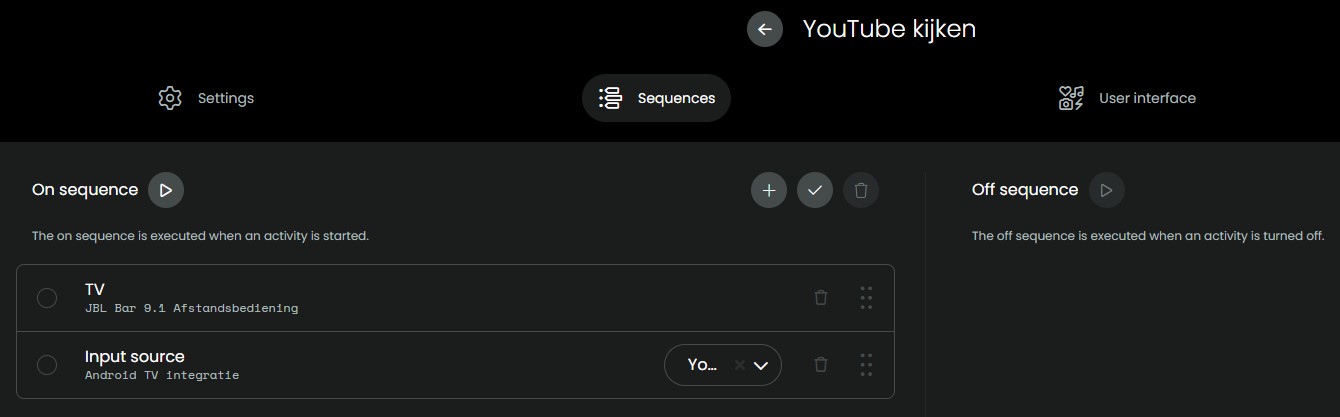

Since beta 2.7.x my Philips Android TV goes in stand-by/power_off when I switch from “YouTube kijken” to “Ziggo kijken”, without editing the Activities & Macros. I have made a log of starting with the Macro “Apparaten aan”, which start all devices and switch off all activities in the Group “kijken”. When the Philips Android TV is fully started, I select first the activity “YouTube kijken”. When YouTube is started I select the activity “Ziggo kijken”, which before these last beta’s started Ziggo TV on HDMI1 OK, but with the current beta’s the Philips Android TV is switched off. Who can help me, why in the new beta’s the Philips Android TV goes in stand-by/power_off and I have to change something or it is a bug in the new beta’s?

I found a bypass to prevent the Philips TV being switched off between “YouTube kijken” and “Ziggo kijken”, by add the entity Android TV integration to the activity “Ziggo kijken”. For the activity “Ziggo kijken” I did not need a command from the Android TV integration, so I had not add it as entity, which was no problem in the previous versions. In the new beta’s switching from an activity with Android TV integration to an activity without Android TV integration results in switching off the Philips Android TV.

For all activities I use the Philips TV and the JBL Soundbar, I start them in the macro “Apparaten aan” and stop them in the macro “Apparaten uit”, with the power button of their remotes. So, in the activities I do not have to switch them on or off, but it looks that the Android TV integration is changed between the beta’s, which results in switching off the Philips TV.
