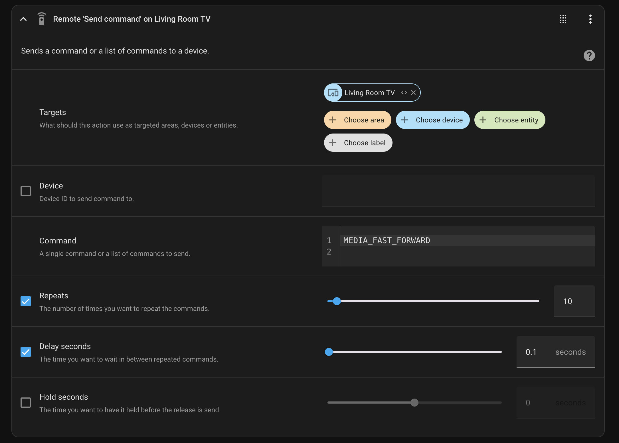

Regarding Fast Forward on AndroidTV, my current hack to make this livable was setting up scripts on Home Assistant for Fast Forward and Rewind
This is clearly something that should be managed by the remote itself, having Home Assistant as a middle man is, IMHO a bad hack.
I also have a feeling that this (Home Assistant) integration fails less than the Android TV one.
Were the Fast forward and Rewind commands in Android TV not working for you?
They work, but they are missing the “fast” part, as the repetition rate is so slow its unusable if you want to fast forward quite a bit.
