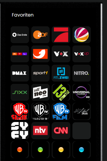

Concerning channel 103: I created macros with 1, delay, 0, delay, 3 (optional delay+enter). I created an icon widget with the macro as entity and I could add a personal icon as a label. Icons for the display must be 90x90 in size..
This is how one of my activity pages looks like:

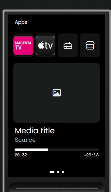

I also have a similar page for direct start of Apps. The R2/R3 have almost unlimited possibilities. The basic is similar to Harmony, Activities, Start/End Sequences, button and display mapping. The main difference is that the Harmony supported you with wizards and more or less useful presets.

What do you mean with OLED? The display auf the remote? If yes the magic word is input or source. Normally you should see then below the command a list of installed Apps. If you create an icon widget you can also define/upload a suitable Icon like on my display.
As I said Apple TV only for fun so only 2 Apps defined.
