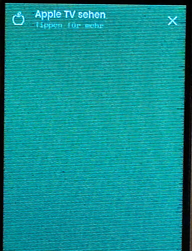

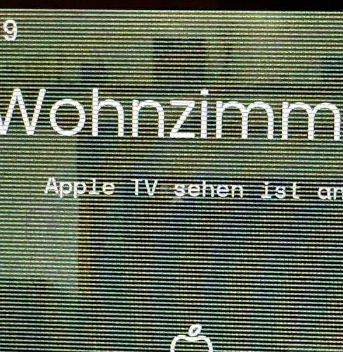

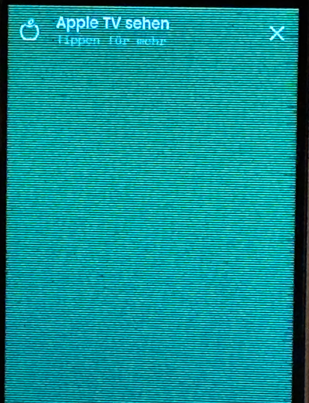

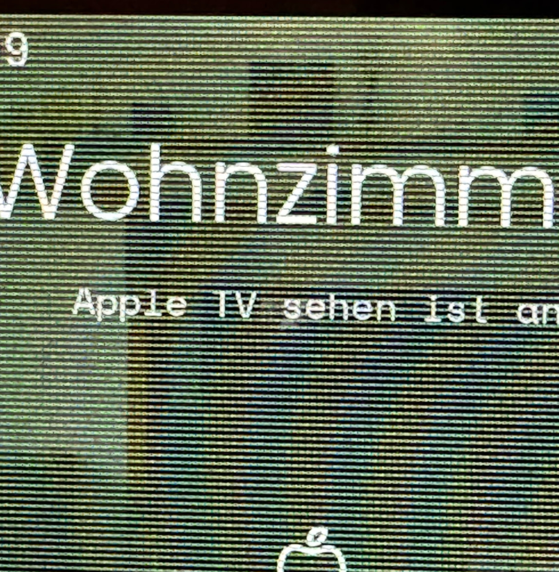

When just picking up the Remote3 from the table, it woke up and has shown stripes on the screen. The remote still seems to work, but the display looks quite strange:
Does anybody know, why this happens?
when doing a complete restart of Remote3, the screen looks fine again.
Firmware version? In the last beta versions they changed something. Version 2.8.1 is latest firmware.
I am using 2.8.1.
Contact support. I never read that it happened with 2.8.1
It also happens with 2.8.1 but seems to be gone after the display turns on again and doesn’t need a reboot anymore: [bug] UI artifacts along the bottom edge of the Remote 3's screen · Issue #561 · unfoldedcircle/feature-and-bug-tracker · GitHub
