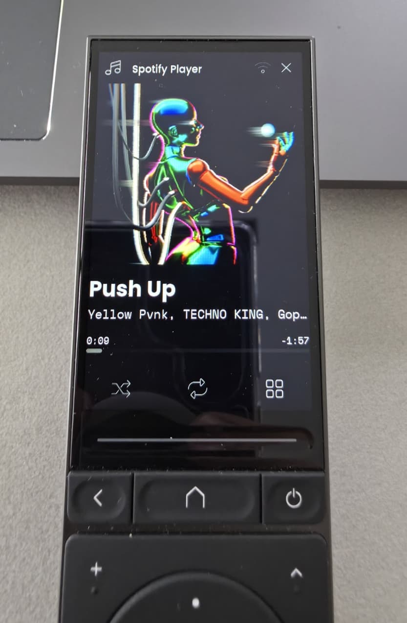

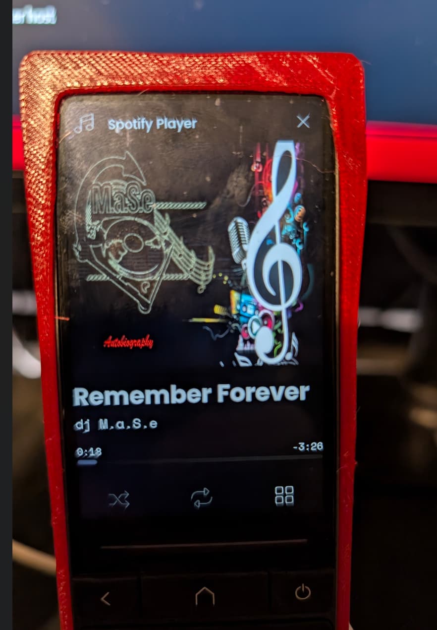

Hello Everyone, i created a custom integration for Spotify.
The integration will give you both a Recently Playing media as well as a remote.
This integration will also ask you if you are a Premium or Free tier account.
IF premium: integration will give you full controls.**
**IF free:**Integration will strip out the control functions. On the Media Player clicking on the buttons will do nothing (and will not show an error) and If you add the remote entity it will display on the screen: Premium Features Only".
Now: This is not your typical integration, it does require you to create a (Free) Spotify Developer Account so you can get the Client Secret and Client ID. The steps are super simple and everyone can do it.
Additionally the integration will work and control Spotify no matter where you are playing the music from, regardless of the device.
IMPORTANT: I have no Spotify Premium Account - so i could not test premium features. Integration working for me as non premium - whoever have premium i would love a feedback and if it doesn’t work i need logs. Basically : need some help from a Premium user :slight_smile:
IMPORTANT 2: It will only display in english (Sorry!!!) if you are playing music with non English Characters they will not be displayed on the screen correctly.

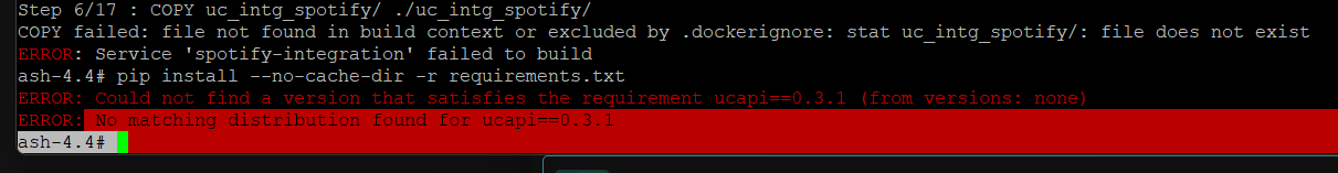

seems there is something wrong with your docker commands ?
docker-compose file not found or working.. or the package is not found on synology…
try a simplified version , create your own docker-compose that will fit your usecase: trial and error.

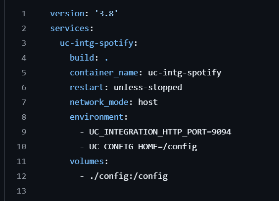

i made a mistake in the URL, the correct URL is : https://raw.githubusercontent.com/mase1981/uc-intg-spotify/main/docker-compose.yml
updated the README.md file. can you try that?
Ah that works better.
When running docker-compose, I also got the message that i needed a Dockerfile ‘file’, so I created one with stuff in that I thought was needed… but I’m not sure.

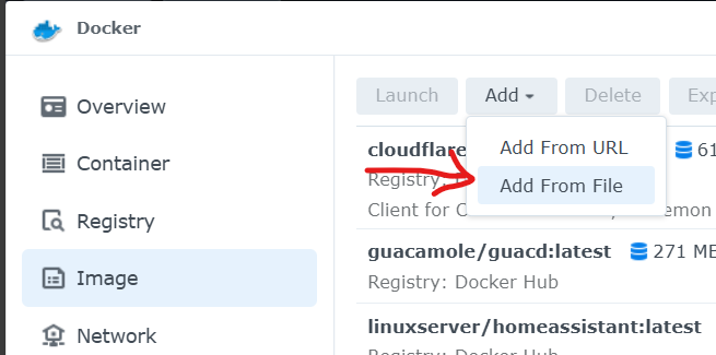

On synology there seems to be a different installation for requirements if it’s even possible to install them on syno.
Do you have an image file that I can upload to docker itself maybe ?
No, i do not. i did not build an image to host, i provided best guess instructions for docker. i use and developed this on local tar.gz but you can build your own image using these files using portainer. Build a new image | Portainer Documentation

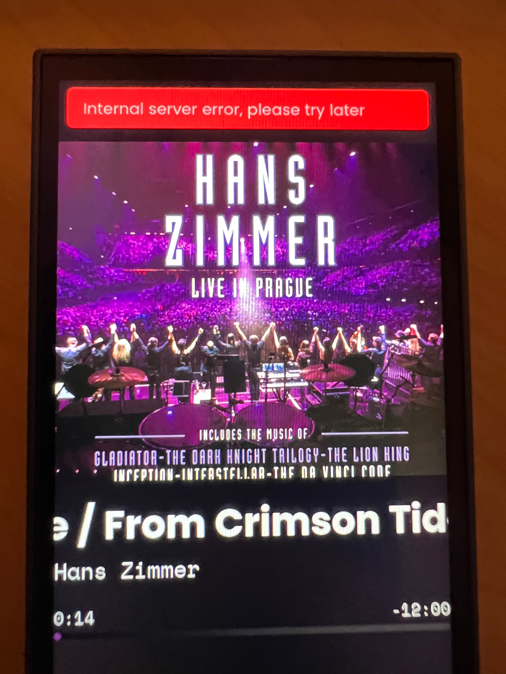

Hey,

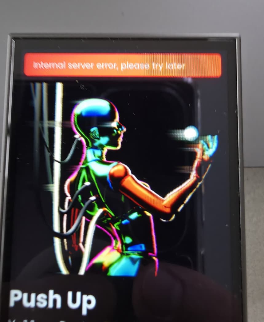

I have the same issue but I am using it directly on the UC. No external docker or so involved.
Commands all work but show the error.
Also update of what’s playing is quite slow updating.
any idea how to get that fixed?

this are the logs. I was just using next and previous to test:
2025-11-13 17:42:34.649772 +00:00 custom-intg-spotify INFO 2025-11-13 18:42:34,648 | DEBUG | ucapi.api | [(‘127.0.0.1’, 35960)] =>: {‘kind’: ‘event’, ‘msg’: <WsMsgEvents.ENTITY_CHANGE: ‘entity_change’>, ‘msg_data’: {‘entity_id’: ‘spotify_media_player_main’, ‘entity_type’: <EntityTypes.MEDIA_PLAYER: ‘media_player’>, ‘attributes’: {<Attributes.MEDIA_TITLE: ‘media_title’>: ‘Driving / Discombobulate / Zoosters Breakout - Live / From Driving Miss Daisy / Sherlock Holmes / Madagascar’, <Attributes.MEDIA_DURATION: ‘media_duration’>: 457, <Attributes.MEDIA_POSITION: ‘media_position’>: 21}}, ‘cat’: <EventCategory.ENTITY: ‘ENTITY’>}
2025-11-13 17:42:34.647318 +00:00 custom-intg-spotify INFO 2025-11-13 18:42:34,646 | DEBUG | ucapi.entities | [configured]: entity ‘spotify_media_player_main’ attributes updated
2025-11-13 17:42:13.326359 +00:00 custom-intg-spotify INFO 2025-11-13 18:42:13,325 | DEBUG | ucapi.api | [(‘127.0.0.1’, 35960)] ->: {‘kind’: ‘resp’, ‘req_id’: 7, ‘code’: 500, ‘msg’: ‘result’, ‘msg_data’: {}}
2025-11-13 17:42:13.325236 +00:00 custom-intg-spotify INFO 2025-11-13 18:42:13,324 | ERROR | uc_intg_spotify.client | Error making authenticated request: 200, message='Attempt to decode JSON with unexpected mimetype: ', url=‘https://api.spotify.com/v1/me/player/previous’
2025-11-13 17:42:13.069478 +00:00 custom-intg-spotify INFO 2025-11-13 18:42:13,067 | INFO | uc_intg_spotify.media_player | Media player command: previous None
2025-11-13 17:42:13.069478 +00:00 custom-intg-spotify INFO 2025-11-13 18:42:13,066 | DEBUG | ucapi.api | [(‘127.0.0.1’, 35960)] <-: {“kind”:“req”,“id”:7,“msg”:“entity_command”,“msg_data”:{“cmd_id”:“previous”,“entity_id”:“spotify_media_player_main”,“entity_type”:“media_player”}}
2025-11-13 17:42:04.402275 +00:00 custom-intg-spotify INFO 2025-11-13 18:42:04,400 | DEBUG | ucapi.api | [(‘127.0.0.1’, 35960)] =>: {‘kind’: ‘event’, ‘msg’: <WsMsgEvents.ENTITY_CHANGE: ‘entity_change’>, ‘msg_data’: {‘entity_id’: ‘spotify_media_player_main’, ‘entity_type’: <EntityTypes.MEDIA_PLAYER: ‘media_player’>, ‘attributes’: {<Attributes.MEDIA_TITLE: ‘media_title’>: ‘Crimson Tide / 160 BPM - Live / From Crimson Tide / Angels & Demons’, <Attributes.MEDIA_DURATION: ‘media_duration’>: 734, <Attributes.MEDIA_POSITION: ‘media_position’>: 4}}, ‘cat’: <EventCategory.ENTITY: ‘ENTITY’>}
2025-11-13 17:42:04.399783 +00:00 custom-intg-spotify INFO 2025-11-13 18:42:04,399 | DEBUG | ucapi.entities | [configured]: entity ‘spotify_media_player_main’ attributes updated
2025-11-13 17:41:59.687377 +00:00 custom-intg-spotify INFO 2025-11-13 18:41:59,686 | DEBUG | ucapi.api | [(‘127.0.0.1’, 35960)] ->: {‘kind’: ‘resp’, ‘req_id’: 6, ‘code’: 500, ‘msg’: ‘result’, ‘msg_data’: {}}
2025-11-13 17:41:59.685998 +00:00 custom-intg-spotify INFO 2025-11-13 18:41:59,684 | ERROR | uc_intg_spotify.client | Error making authenticated request: 200, message='Attempt to decode JSON with unexpected mimetype: ', url=‘https://api.spotify.com/v1/me/player/next’
2025-11-13 17:41:59.294726 +00:00 custom-intg-spotify INFO 2025-11-13 18:41:59,294 | INFO | uc_intg_spotify.media_player | Media player command: next None
2025-11-13 17:41:59.294726 +00:00 custom-intg-spotify INFO 2025-11-13 18:41:59,293 | DEBUG | ucapi.api | [(‘127.0.0.1’, 35960)] <-: {“kind”:“req”,“id”:6,“msg”:“entity_command”,“msg_data”:{“cmd_id”:“next”,“entity_id”:“spotify_media_player_main”,“entity_type”:“media_player”}}

@malkie can you please try this beta version and tell me if the issue has been resolved? if so, i will mark it official, if not - provide new logs please. thank you. Release v1.0.0 · mase1981/uc-intg-spotify · GitHub
@Sam1an in this version i also added a docker image to make it easier. FYI. test the beta version and let me know if all working.
partly sucess. Next/previous, volume up/down work without error.
Pause/Play does not work and shows the error.
Also I do not see in the mediaplayer anmore what is playing or the time bar.I uploaded the logs on pastebin

thanks. looking at the log.
