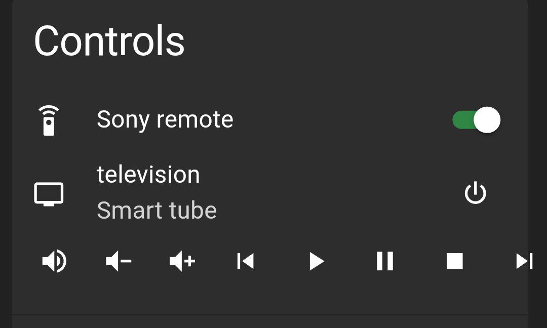

No factory reset should be needed. I can’t remember if the Android Remote HA I tegration has a slider but ADB does. I’m waiting on my R3 so I imagine you added the media player to an activity. Can you map.sceipgs to buttons? It sounds like IR is a no go and Android TV remote doesn’t work from the R2 but does it work using the HA companion app from your phone?

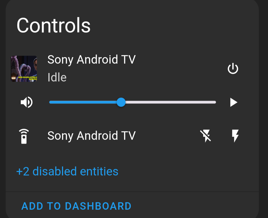

I would try ADB, you have to enable developer tools and enable USB debugging which usually turns on network ADB debugging on. Unfortunately it’s some. Python implementation and not a full ADB server but the screenshot of ADB has a volume slider. Android TV Remote doesn’t but it may once added to the R2. When you first add the TV by IO you will get a certificate warning. Check always trust this device then okay.

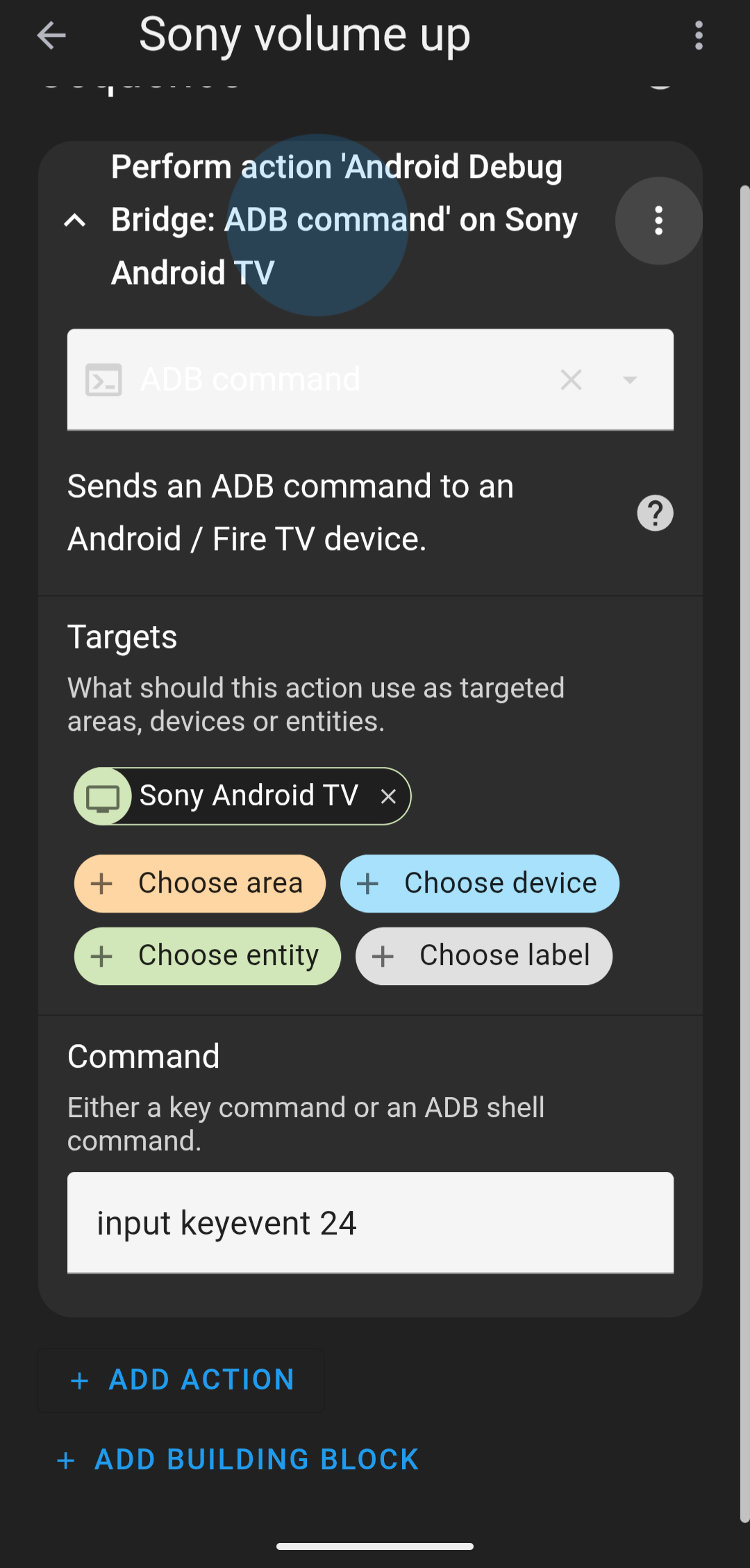

###Vol Down
data:
  command: input keyevent 25
target:
  entity_id: media_player.sony_android_tv
action: androidtv.adb_command
###Vol UP
data:
  command: input keyevent 24
target:
