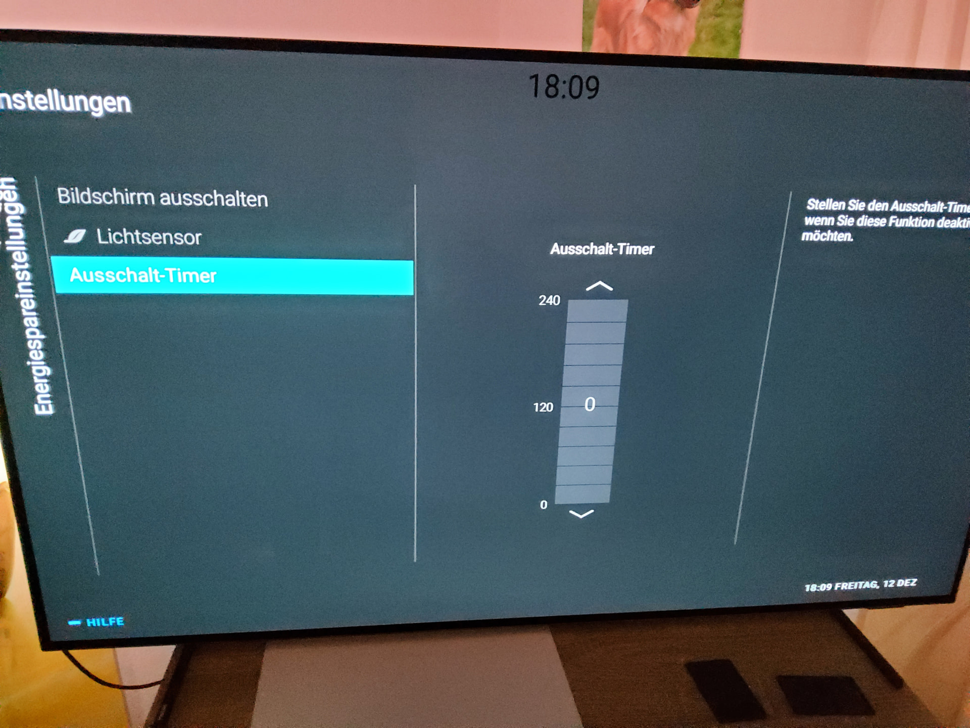

What about “Ausschaltertimrer"? Or ask Google how to prevent it.
All timers are deactivated. Also the “Eco”-ones.
I asked google several times with different questions about that but didn’t get any answer that solves the problem.
Don’t you have these settings?
