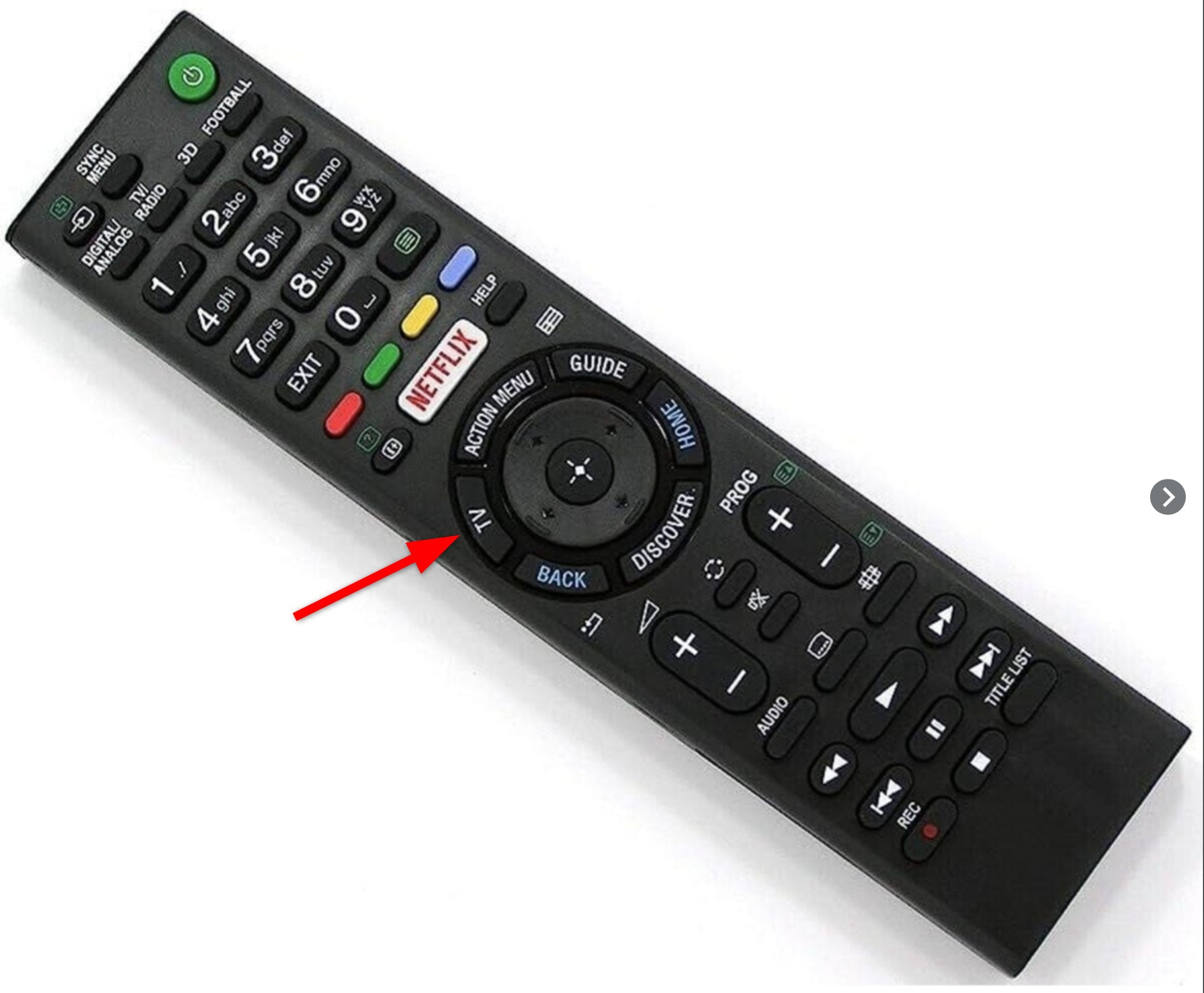

Already installed the Android TV integration - what I’m missing there is the “TV” button.

The TV button brings you back to the HDMI inputs:
But in the meantime I found out that I can mange that by using a Home Assistant integration.
With ADB and I think with HA you have the possibilty to switch direct to an input. Much better than original remote.
Isn’t the command included in the Generic Sony TV code set? Otherwise you can just learn it from the original remote. But as Ralf wrote you should prefer integrations like ADB or the Sony TV custom config for the requests integration.
