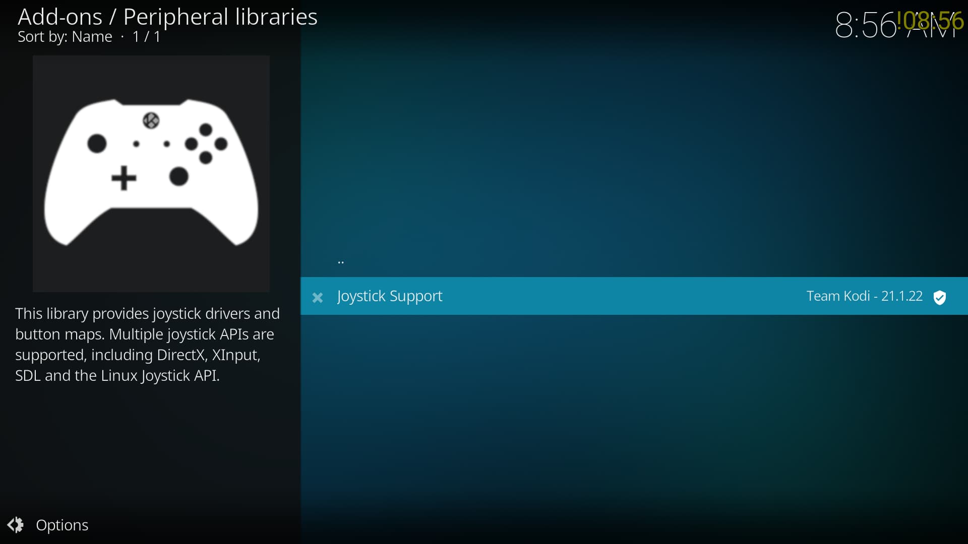

If you use Android TV integration and Kodi App you must disable Joystick support in Add-ons/Pheripheral libraries like in this screenshot:

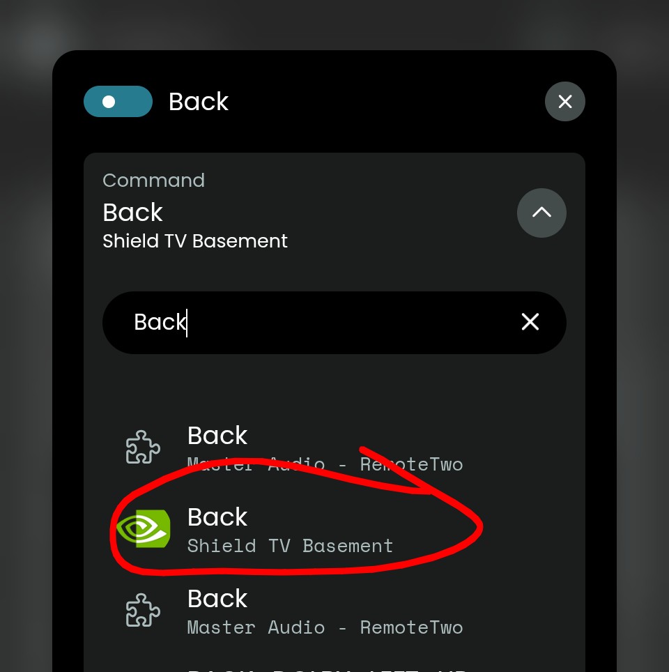

You don’t need to connect via Bluetooth. I’ve been using the integration for my shield TV since day one on the R2. It has worked for years. Behavior is the same on the R3 as well. Go into your activity and assign the “Back” command from your Shield source to the back button. Then try. Also, you can test in the actual entity by itself too. See if it works that way, then you know it’s your activity. FYI, I don’t really use Kodi, so not sure about that. But I know the back button works perfectly fine in both my activities and the device as standalone.
