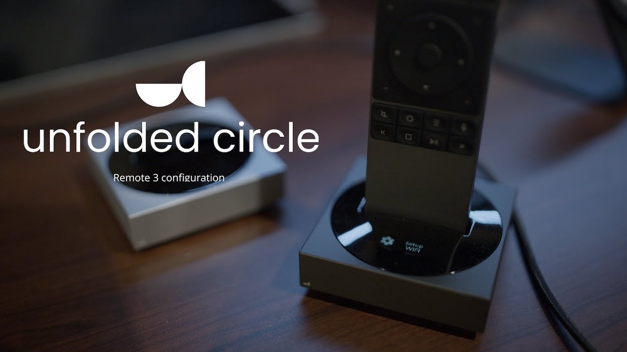

Setup Guide Video
Hi all. I created a basic Remote 3 setup guide on YouTube for those receiving their first UC remote. It has some basic tips and best practices plus a step by step for adding integrations, custom integrations, building an activity and more.
I’m NOT a developer, so hopefully it’s easy-ish to follow.
I’ve been using the Remote Two for about a year and a half, and I struggled when it first arrived.
Unfolded Circle Remote 3 Configuration
