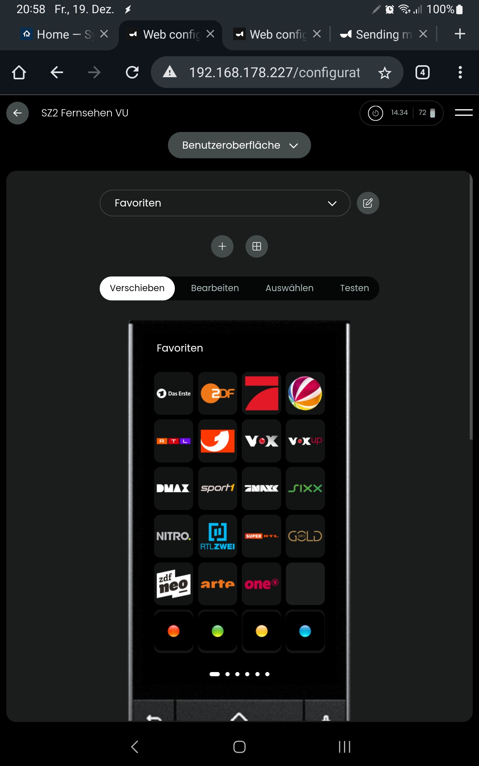

Right now I am setting up my Watch-TV activity. I would like to build one page, showing all TV-channel icons. When clicking an icon, the IR-sequence shall be send (like digit 1 + Cursor_Enter or sending two digits and maybe a delay is needed in-between as well).
How can I get this done? So far I can only assign one single IR command.

Yes you can😁 I did it around 80 times it is long and boring work but the result with channel picon is it worth
