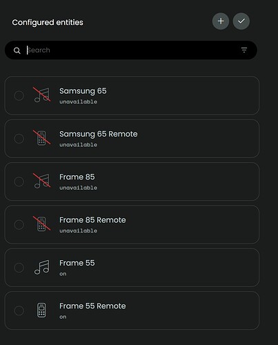

The Samsung TV integration will add 1 entity successfully. However, when adding additional Samsung TV entities all previously added will become “unavailable”. Only the last one added will continue to work. Is the integration designed for only 1 entity? I would like to add 6 Samsung TVs.
The Samsung integration supports more then 1 tv only one integration needed. Run setup to add 1st TV then run setup again to add 2nd tv and so on.
Here is what happens when adding more than 1 TV
Are all switched on? I only have 1 Samsung. You can ask on the project page of git or in discord the author directly.
Yes all are on. I have deleted all and started over numerous times. If I only keep one it works great. As soon as I add a second or more all previous additions go unavailable…
Are the unavailable entities still shown in the available entities list if you delete them from the configured entities list?
Very odd. I have 3 Samsung TVs and it works fine for me. As others have said post on the Samsung TV Integration area in the Unfolded Circle Discord or contact the author directly.
I removed from configured entities and now they do not appear in the available entities
OK thank you.
You should contact the developer. As mentioned before it should work with multiple devices. Logs would also be helpful (Settings/Development/Logs and choose the integration from the services dropdown)
