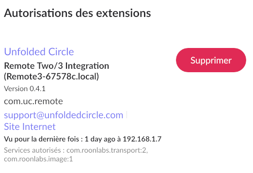

i succeed to setup ROON integration. Extension in Roon app is well allowed.

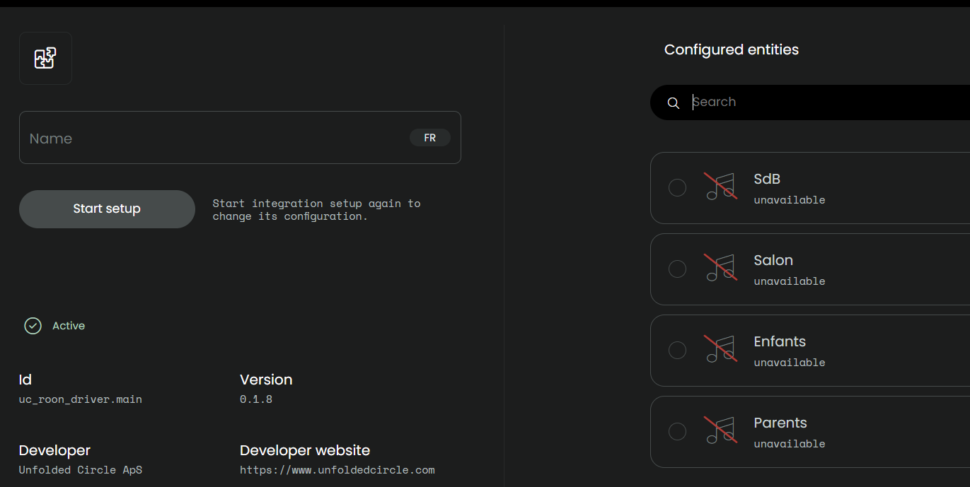

Then i could interact with my speakers. But this evening, all my Roon entities are unvailable. I cannot enable them again.
What i am missing?

Does a reboot of the remote help or re-running the setup process?
I am currently using the Roon integration in Home Assistant because last time I looked at the UC integration I sometimes had connection issue and preferred the HA integration. But I have a HA instance running anyway. Not sure if that is an option for you.
Anyway, it might make sense to raise a bug report and share log files with the UC team here: GitHub · Where software is built
SOLVED: i set up static IPs for remote/dockers and no more issue.
