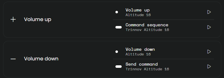

For the Roon integration developers, any intention to add a volume control into the integration, specifically for a set-up where the device (in my case a DAC without volume control and a intergated amp accepting only IR) does not have a device volume control. It would be great to have the ability to press the volume up & down buttons in the Roon app and trigger sending a IR code the amp.
Thanks,
Z
Hi, this should already work. Put all your needed entities into a activity and configure as you want.

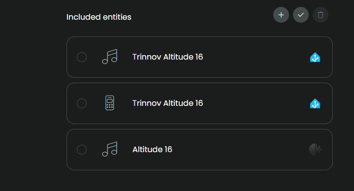

That would be great. Can you share a screenshot how this would look like? I have the UC extension installed in the Roon app but in the Device setup I only get Fixed, Device, DSP or home assistant as options for volume control.
put the Media Player or Remote of your amp or pre-amp and the Roon ready entities in one activity.
Configure your buttons as you like.
