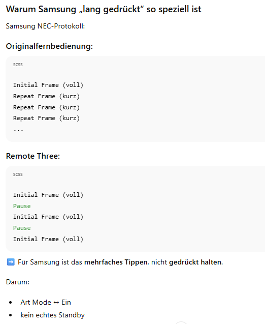

I think the IR signal isn’t being repeated quickly enough when the button is pressed for a long time. With the button pressed, the TV keeps switching on and off.
When the power button on the original remote control is pressed, the red reception light on the TV flashes very rapidly. With the Remote 3, the flashing is much slower. I think, this is the problem.
So I’m looking for a solution to repeat the IR signal for 2 seconds without a pause. Tanks Peter
