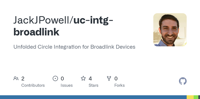

Another idea before you get a heart attack. There is also a Broadlink integration which perhaps could replace the dock. I did not try it:
I am not using a dock anymore for my R2 and R3.
What little IR I need is handled by the wonderful Broadlink integration tied to an RM4 Pro.
The strength and range of its IR emitter make the UC docks look like paperweights.
I’m thinking of selling my R3 docks and possibly the R2 dock as well.
Thank you Ralf. Im using the Roku and AndroidTV (Sony) integrations. I appreciate the assistance.
Thanks Harvey. I will check the Broadlink transmitter out.
