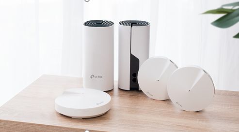

I use a tp link deco mesh system.
Mesh systems are known to cause issues once in a while.
Could you please check your TP-Link system and check if “fast roaming” and “bss transition” are turned off? I am not familiar with TP-Link but maybe this helps:

Yeah. And for OP and me it sometimes never reconnects (or only by going to WiFi settings). It sure is broken but in my case it helped to disable BSS transition and fast roaming. That’s why I suggested to check if the WiFi equipment supports changing these settings. It sure is just a temporary fix - in the long run this needs to be fixed in a R3 firmware update.
