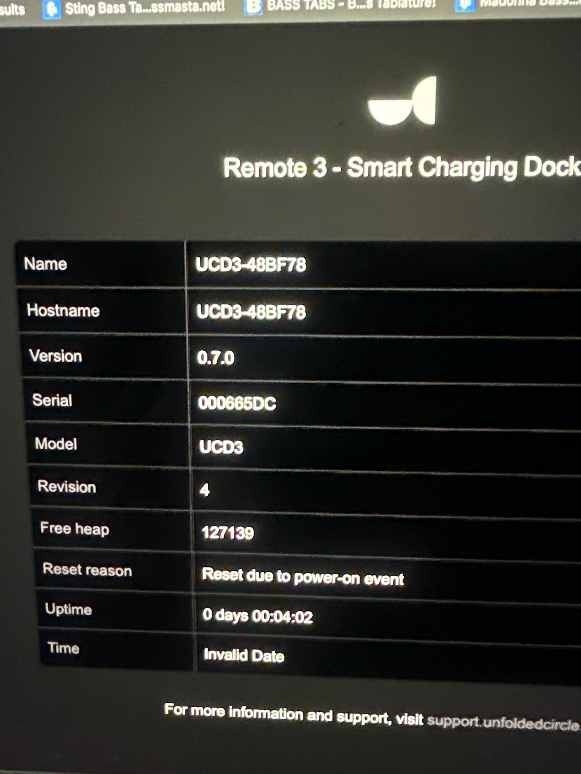

0.7.0

Your dock firmware is outdated and known to cause charging issues. If you can’t access the remote web configurator to update the dock firmware you can also open http://dockip/update and upload the 0.8.1 release file from here: Release v0.8.1 · unfoldedcircle/ucd3-firmware · GitHub

When I enter just the IP I get a dock details screen.
