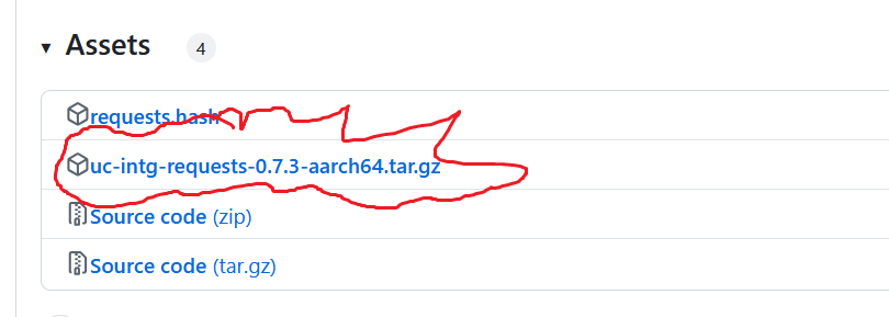

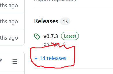

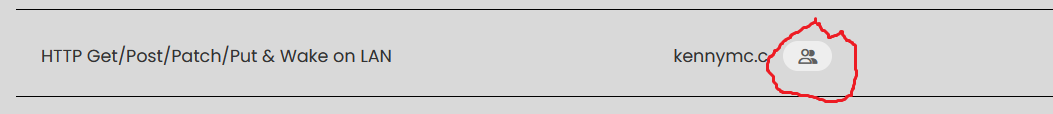

Click on the icon right from the author and you will directed to his git repository. On the right you see releases and when you click it you get to the download section. DOwnload the .tar.gz file and this can be uploaded to the remote.

Normally select an integration from the list and press the marked icon:
Then you will get to the git and press the marked releases on the right:
Then download the marked .tar.gz file. This can then be uploaded to the remote in integrations, + for add and then custom integration:

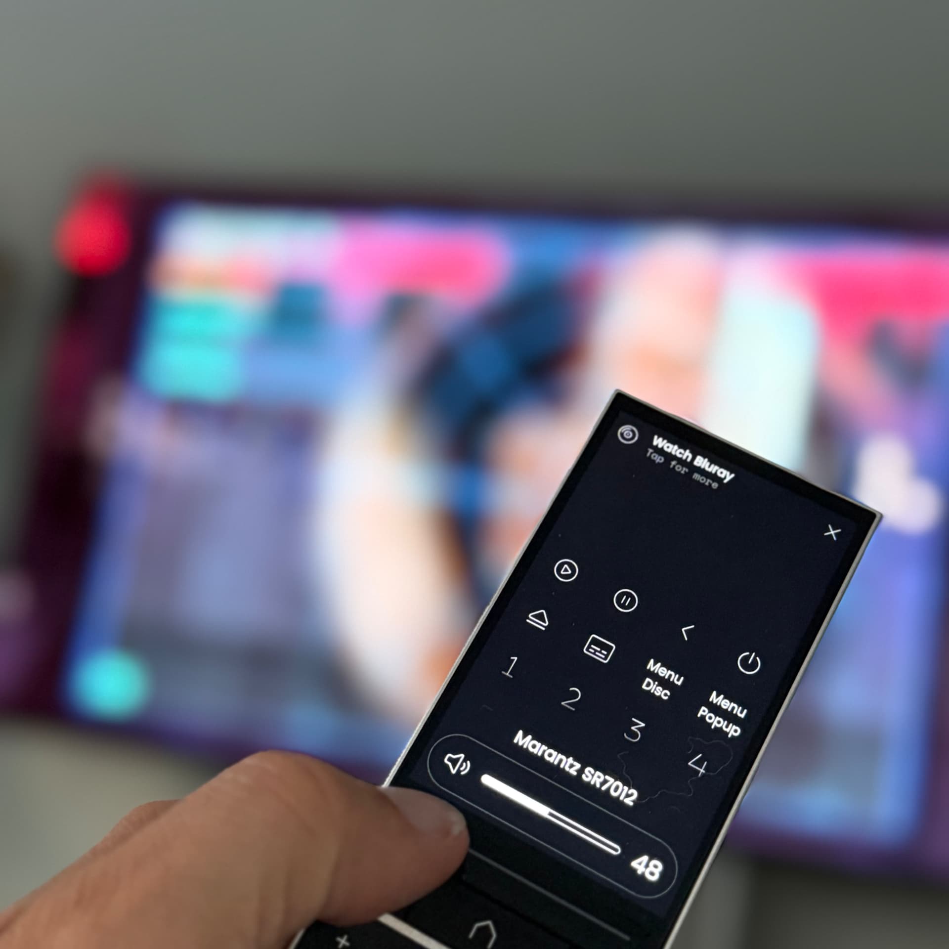

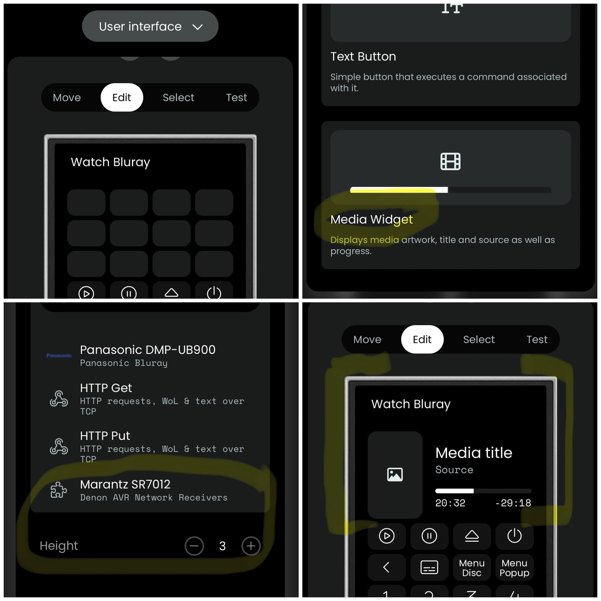

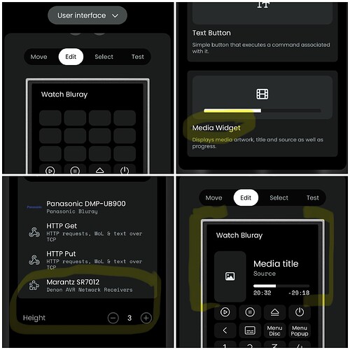

Yes, you need to add your amplifier as a media widget in the user interface in your activity. The entity used in the media widget is controlling the slider.
In the example below, I’ve added my Marantz amp as a media widget in the activity “watch bluray”.
After installing the media widget the slider will control the volume of the Marantz amplifier:
