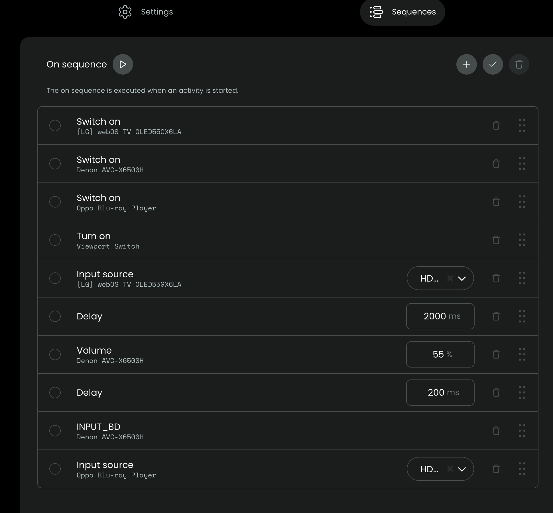

The Oppo Blu Ray integration supports the UDP-205 and you can select the inputs. I do this for my 203. GitHub - henrikwidlund/unfoldedcircle-oppo: Unfolded Circle integration driver for the Oppo Blu-ray players
Thanks for your reply. This is the integration I'm using. I can't find the command to switch sources. Can you help me? What's the command called? Thank you, Peter
Strange. You can see I have this in my setup here.
Note: Selecting input on the player can only be done when the player reports that it is on, this means that you have to place a delay between the Switch on and Input source commands if you want to use this in the On sequence, or the remote will think the start sequence fails.
Yes. That is Strange. I remove everything with Oppo an install it again. No input source. Now i learnd all IR-Codes. That works fine. Thank you. Peter
