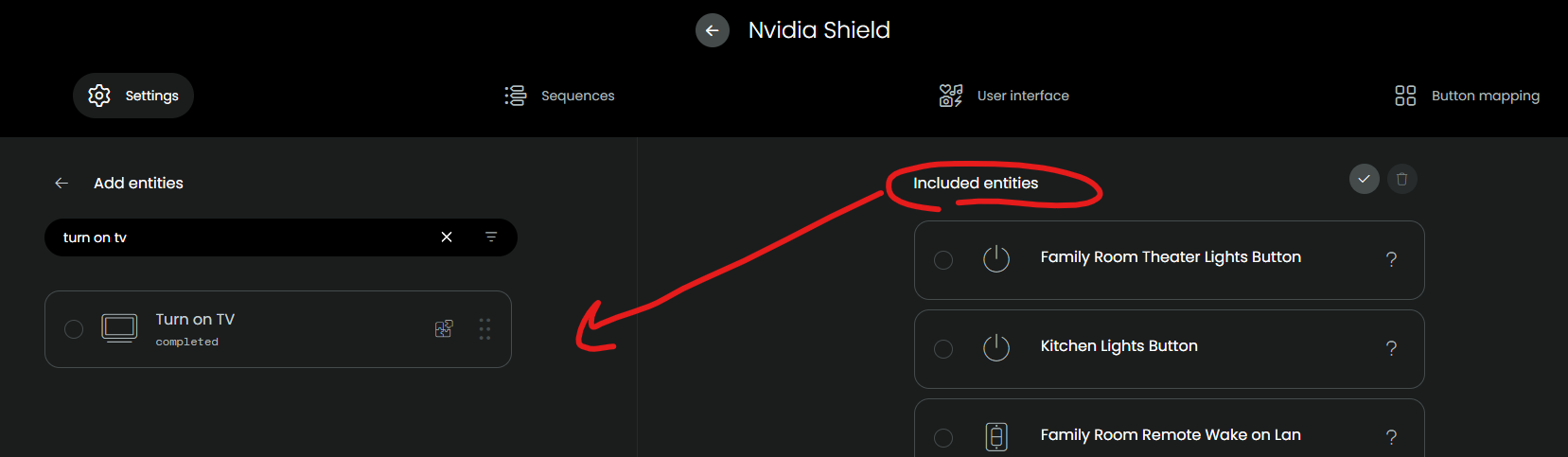

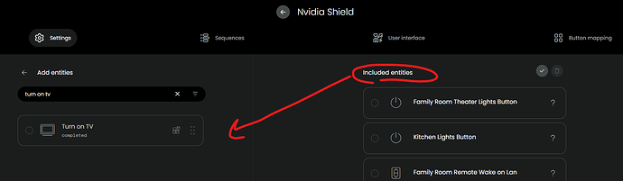

Took a while, but you need to add them as entities:

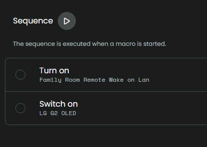

This is what I have in that macro right now:
