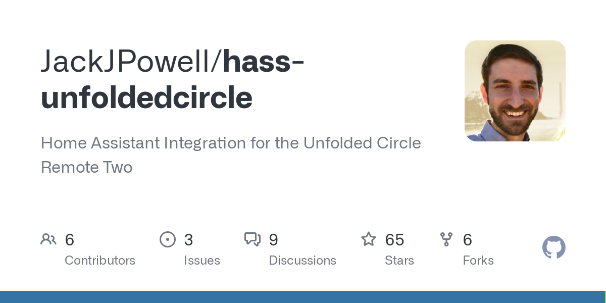

where do I find the file for Unfolded Circle to add to HA?
Easiest to install via HACS:
