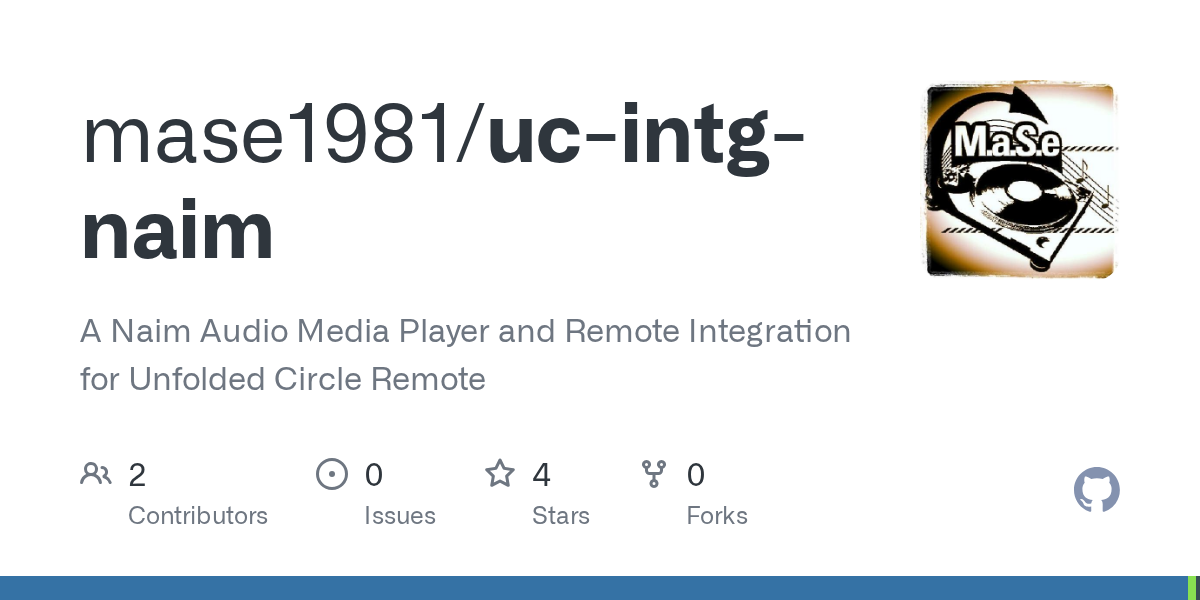

Hey Guys, i have created a Naim integration, please note - i do not own a Naim device, i did this integration ā€œblindā€ using a simulator and the GREAT help from @Gillyshere
it is still missing some buttons that is because i could not find Naim API document anywhere… GitHub - mase1981/uc-intg-naim: A Naim Audio Media Player and Remote Integration for Unfolded Circle Remote
new version 1.0.9 is up - add multi device support and missing commands. (well, hopefully, its all using a simulator script :sweat_smile: )
Hi, Does anyone know if there is a list of commands availabe for this as some are missing from it like the Cursor, OK and Favorites buttons. Thank you for the hard work.
I am missing the same and also in the Input Source Dropdown for the media player I only get 4 options so I’m missing many inputs including Tidal. I do get these as sources listed under the remote entity but these don’t work for me for some reason.
Not all Amp & entries work because they will not share their APIs
Thanks. I am using this integration and my naim streamer works fine with it but as I mentioned the integration just doesnt provide all of the source options for some reason. I can probably access the using Home Assistant and the new entity select function that was just added to the UI but I havent had chance to try that yet.
