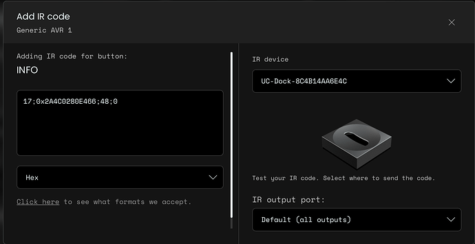

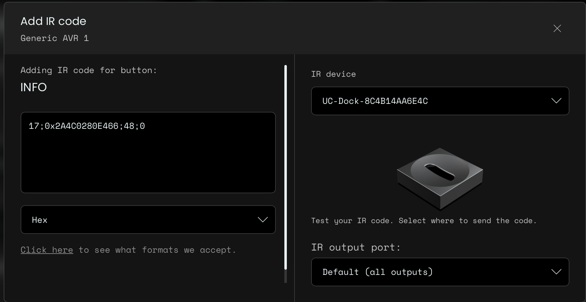

Here’s a screen shot of where I get stuck. There is no save button.
The dock blinks green and then red when it is learning the button. Not sure what that means but it does put a code in the box as the screenshot shows.
The bottom part seems to be cut off. Are you using a low resolution display or a high display scaling? In most browsers you can also use a zoom function to scale down a website.
Thanks! Using MacBook Pro have to have browser in full open (green button) for save to come up. Then had to reboot remote two to get it to work. But it works now.’
