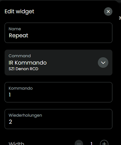

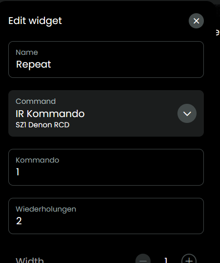

You can also test something different
Select IR command and then enter the command and a repeat values for instance 10 and see what happens.
OK, I will try that as well.
I have tested to send many times (from 2 to 20) the short press IR command but it does not work. My feeling is that it is not the same IR code for short press and long press.
