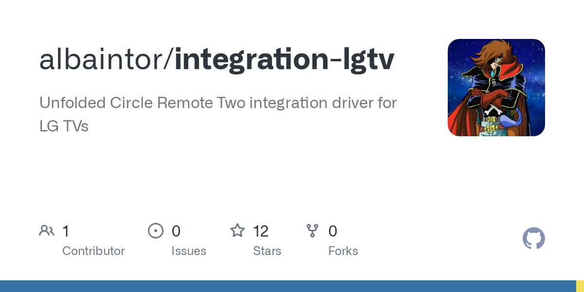

For LG there is also an IP integration available. See here Supported devices

As for the IP integration for LG, where would I find this, @HarmonyFan ? It says so on the support page but when I add an integration on the actual remote, there is nothing listed.
Some integrations in that list like the LG are from community devs. You must click on the name then you are directed to the github page and there on the right side you find a link the the integration releases. In case of the LG it is
you must download the tar.gz and this must be uploaded to the remote.
Have fun you lucky guy with your R3
Thanks for pointing that out, I read “unfolded OS” but did not really realise that it is a proper OS that you could extend and/or modify. I uploaded the custom LG integration but unfortunately, it did not find my LG TV, despite switching on all “quick-start”/“always-on” features on the TV. The LG is connected via Wifi and the network test was positive.
Anyone here has successfully connected an LG TV with the IP integration?
Yes I have. I also had slight problems. I think the automatic detection does not work always and I had to enter the IP.
