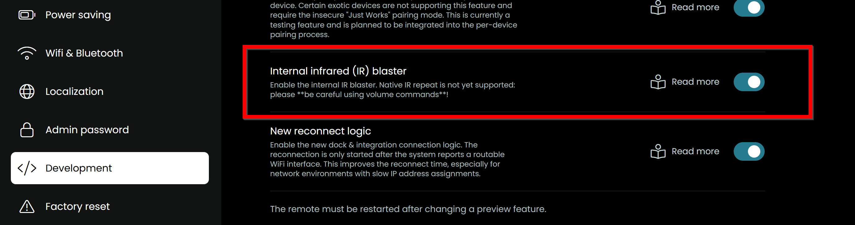

However, when trying to add any IR code manually, all I get is errors
Infrared output device - No output device available WTF does this mean?
Any help appreciated but I am almost at the point of this going back if such an expensive piece of kit cannot do the simple things that most cheap universal remotes can.

At the moment only Dock can learn at lot, not all, IR codes.
The Dock can also send IR. The remote can send, not yet learn, IR if enabled in settings, development, preview features.

Although what I am seeing after adding a device from their DB, I cannot even send IR either.
WOW, just WOW.
Ok, phew, I take it back. It does do it, although I found this instruction nowhere.
You found it 2 posts above​:smiling_face_with_sunglasses:
Yeah cheers, I didn’t get that part, my apologies, still new to these menus.
But at least I can use it for some things, and use HA for those that I cant.
