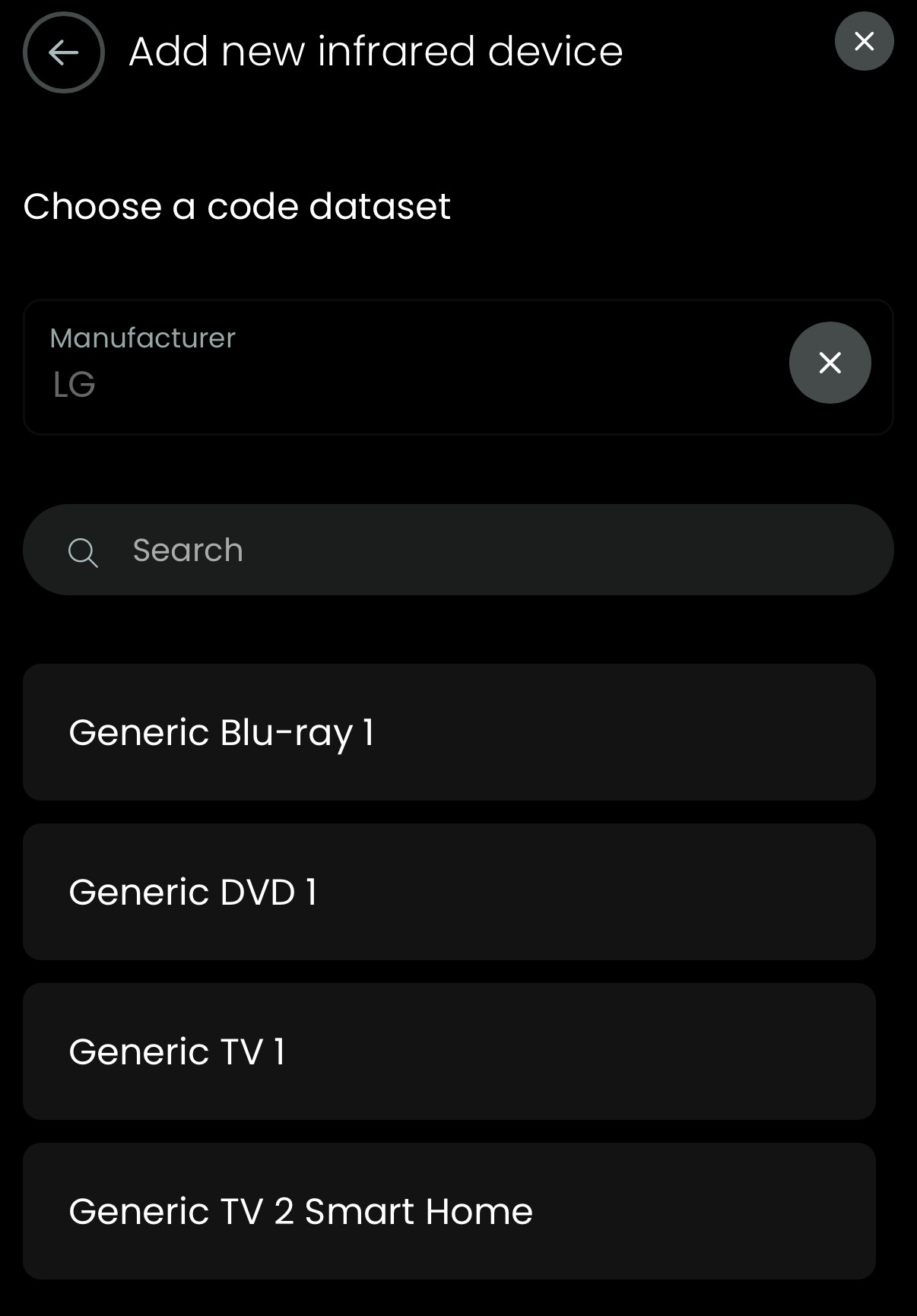

I didn’t get the LG integration to work with my LG OLED tv. I installed the predefined ir-package that is already available in the webconfig to control my LG tv - this works flawlessly.
You can do this by going to Entities > (+) > Add new device / Infrared > next:
Select generic tv 1. Done.
Make sure your dock or blaster are near your tv.
