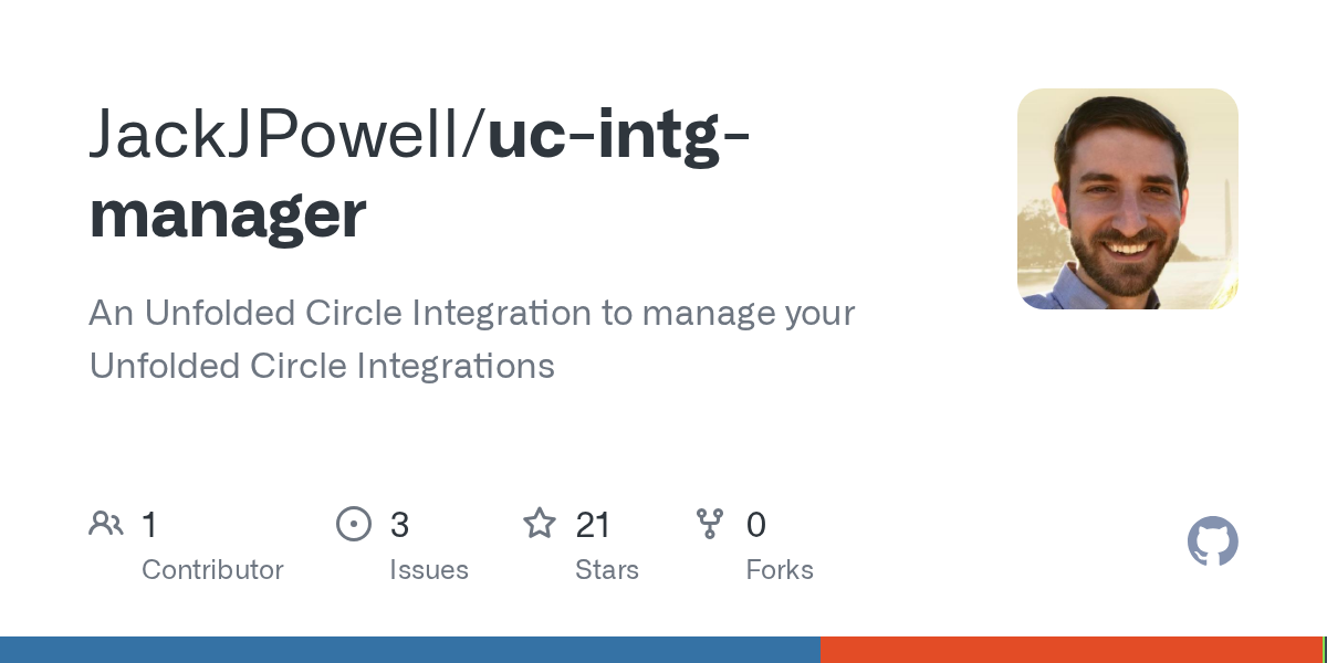

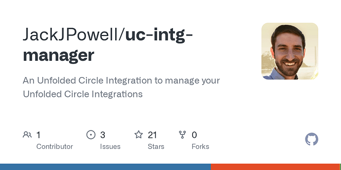

Are you using the integration manager from Jack Powell?
If not, you’re probably going to want to
I do have this integration but it doesn’t always work when installing or upgrading that I ended up just uninstalling/installing the manual way.
I do like how it identifies entity orphans and that there are new versions available. I also use its backup function.
Integrations which are written under ucapi-framework will support an upgrade, integrations which are written under ucpi will not.
Integration Manager will clearly warn you if it is upgradable or not.
if yes, it will retain settings, if not, it will upgrade but will require you to reconfigure
if you do not want to use integration manager - any integration you will need to remove the integration (twice) from web-configurator , re uplaod the latest tar.gz and re configure OR use docker for auto upgrade via docker using watchtower.
