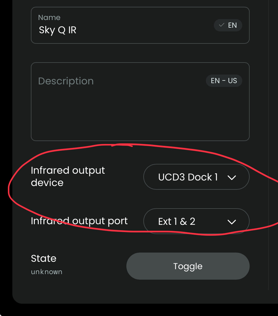

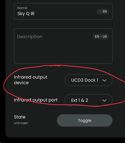

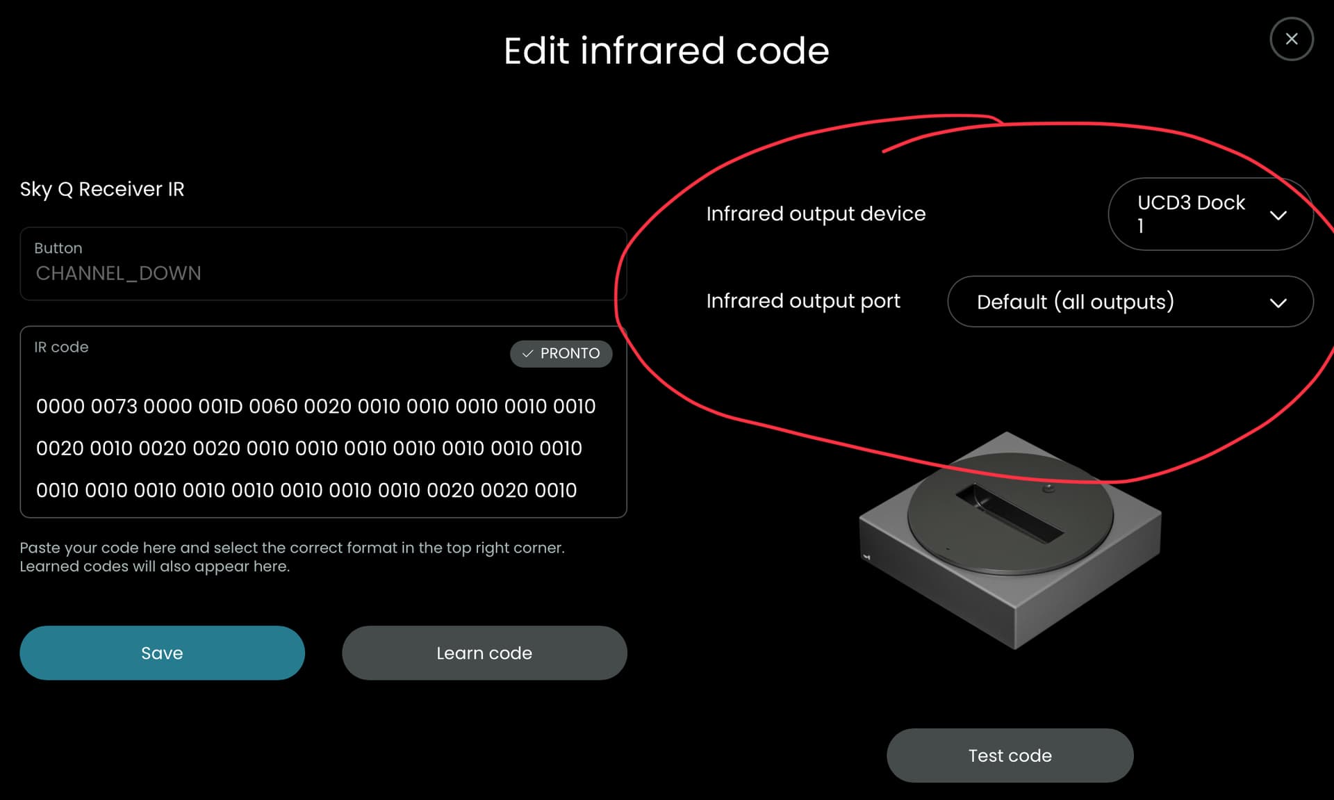

Have a look at the output devices for you IR entities. Maybe they are different from the devices used for testing the Codes.
Genius! Thank you! All working now.
