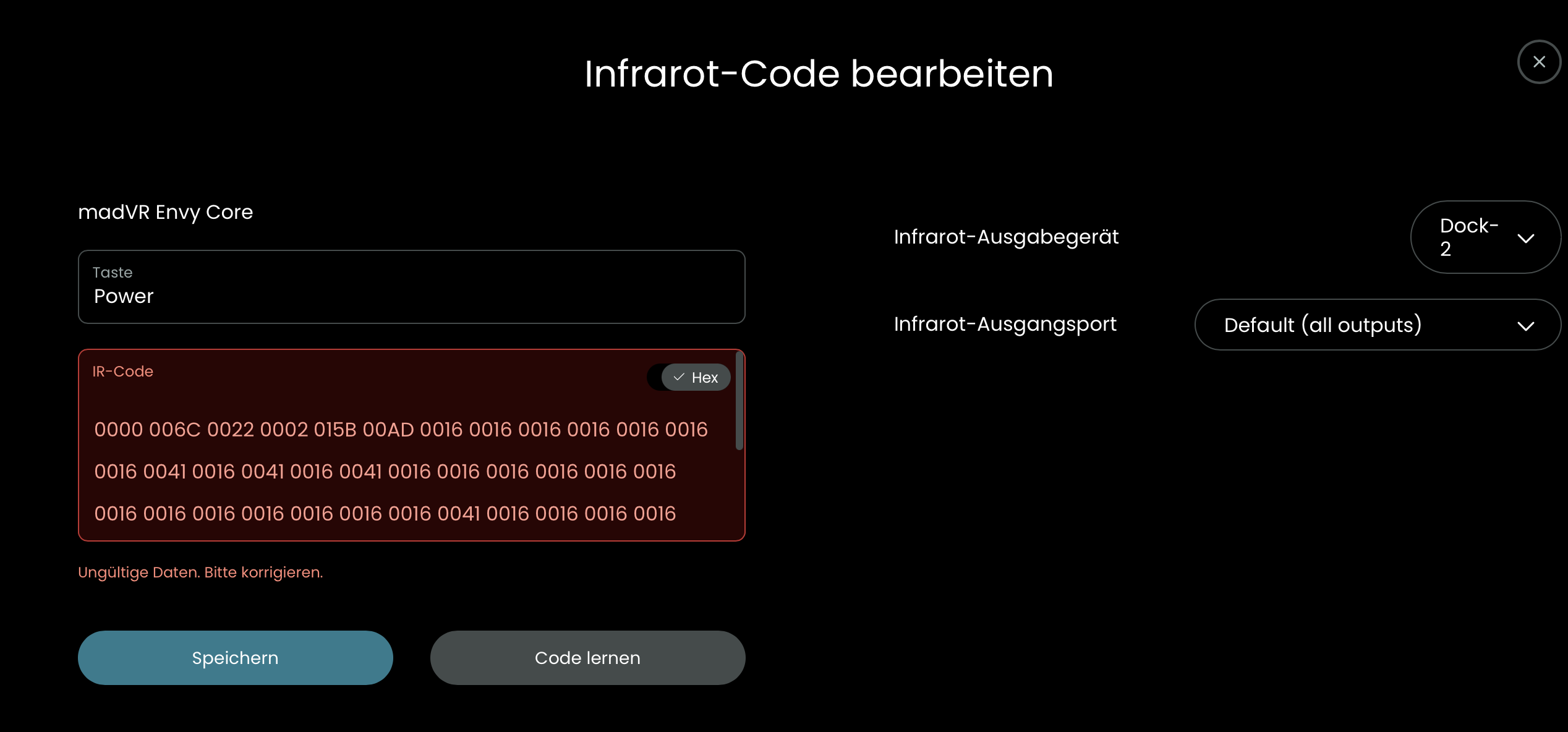

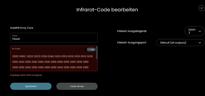

I tried to insert the Hex-Code but it did not work. Can you see what I did wrong?
Attached a screenshot. It would be absolutely awesome if you could help me.
Thank you so much.
Try changing Hex to Proton. Click the Hex button in the IR code field.
Super, thanks, ok now saving was possible.
I have to test it.
I will give an info if it works. Would be awesome :slight_smile:
